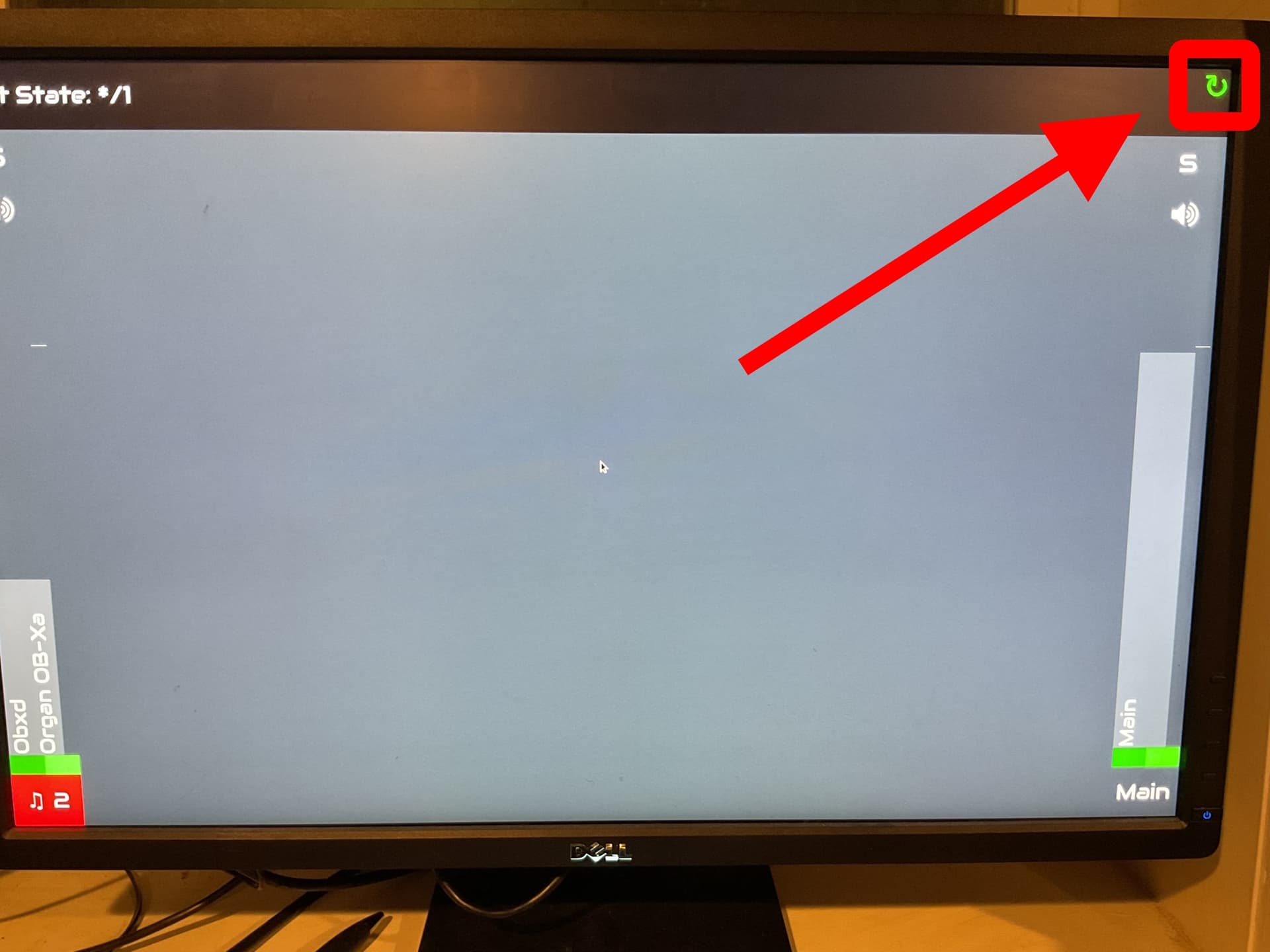

I’m running Zynthian on a Raspberry Pi 4. In the upper right-hand corner of my Zynthian screen, it shows a green circle arrow instead of the green heart icon:
Does this just mean that there’s a new software update? If so, is “green” still “healthy?”

It means software updates are available.
You can update from admin in the gui or via software in webconf.
Thanks @wyleu for confirming. I think instead of updating it directly, I will create a new Zynthian instance on a separate card and restore my snapshots to it.
The update indication does change colour to indicate health, like the heart does.

Hello, personally, I have had this symbol for a long time (stable version), even if I do system updates. I may wait for it to be corrected, in the meantime, it does not prevent me from playing :slight_smile:
If you modified any code under the area for any of the git repositories, git will not update that repository on your machine till you tell git how to handle your alterations.
Git is running the world at this particular point.
Best way to detect this is go into each of the subdirectories of the zynthian directory at the root of the zynth and type git status. One will respond with changes. And this will need addressing.
There is a big in the current stable release which can leave the update symbol showing. I tried to fix it but that didn’t work for everyone. There will be a new stable release in the next few days that I expect to resolve this.
Thanks Riban for the latest version, now everything is ok (version 2502.0)
