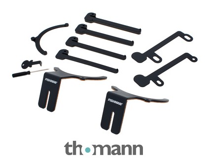

If you buy it you will probably need an installation kit:
My beauties. On the acoustic, there is the rest of the holder. On the electric, there is the TriplePlay.
