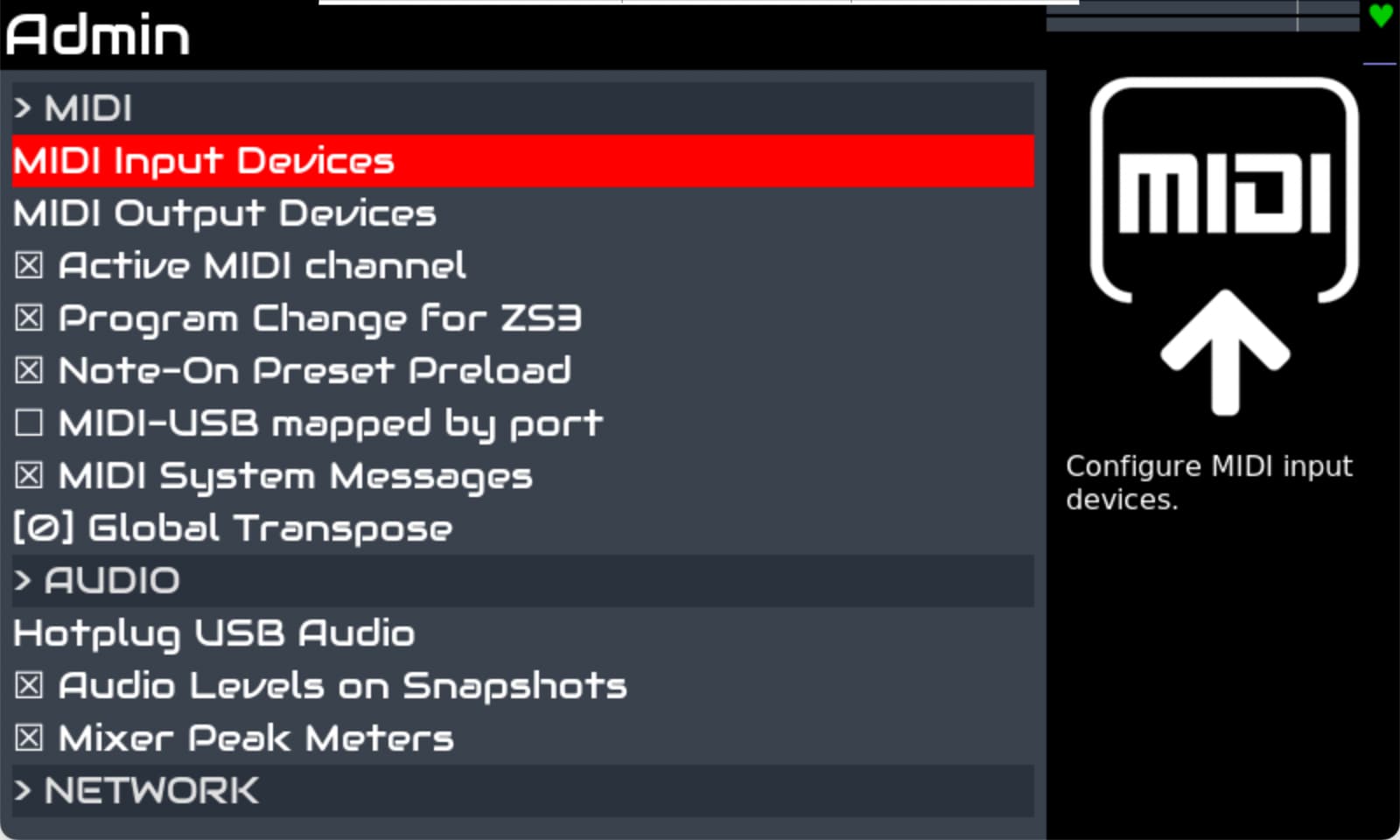

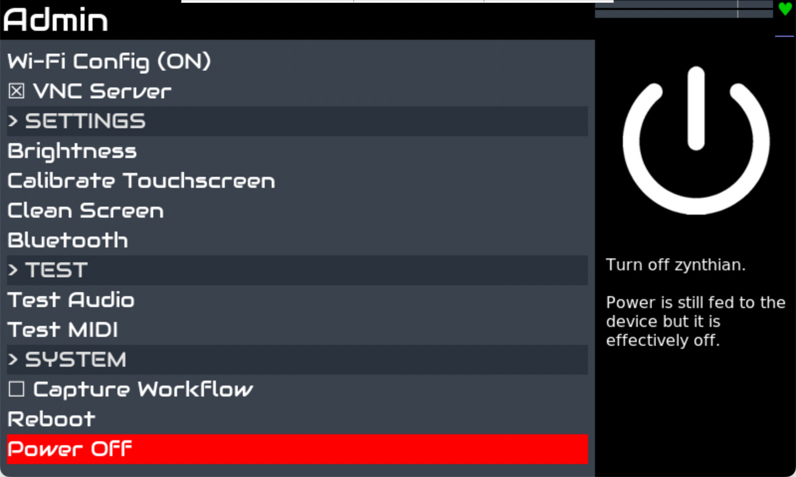

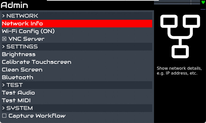

Where is snapshot in admin menu
I cannot find anything mentioning snapshot on the admin menu.
Enclosed are screenshots.
How hav I create and load snapshots (V 5.1)
Why do you want to find it in the admin menu? I don’t think it’s there, or even in webconf. I could be wrong of course.

It’s not in the admin menu, it’s in the main menu, which can be accessed by the top left opt/admin button - tap it to alternate between the two if you’re at the top level, or go more directly by the zs3/shot button, top row, far right. See the more thorough instructions in the post immediately above yours from 6 months ago:
