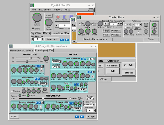

Does anyone have an idea how to get rid of this annoying LFO pitch in the patch Sweet Phased Space in Zynaddsubfx. It’s impossible through Zynthian interface and I had no results using the graphic interface in Webconf, and it seems there’s no correspondece between parameters.

there is the “Frequency LFO” “Depth” parameter in the webconf’s “PAD synth Parameters” window (the lower left one in your image).
Set the Depth of the frequency LFO to 0 and you are good to go.
Well, that was easy. I was simply missing the correct parameter. Thanks!
