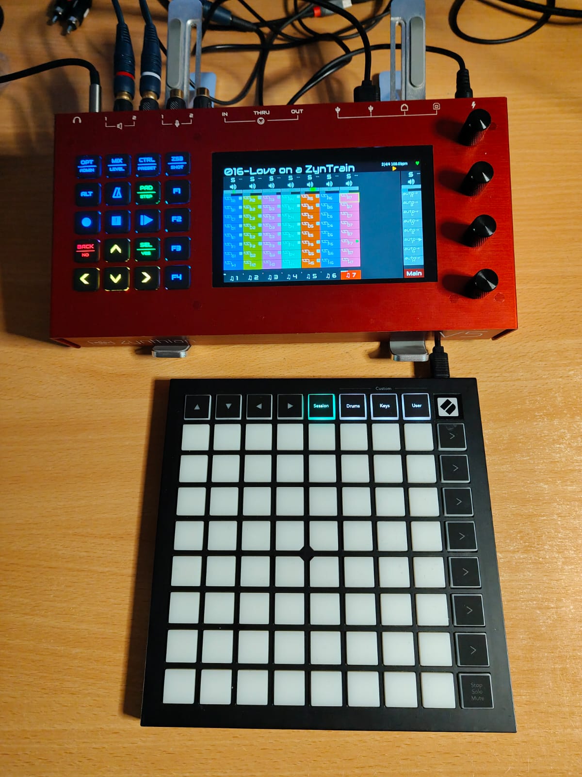

Well… now my Launchpad Mini MK3 is not working anymore in Session mode. All the pads are off with active chains.
This is the same exact problem I got with my LP mini MK3 when updating via webconf from Oram to Vangelis
So went back to Oram
and LP mini MK3 works OK
Alain
We will look at this soon. We are ensuring the APC40 works perfectly then will use that as the template for other hardware controllers to follow.
Fixed now!
Thanks
