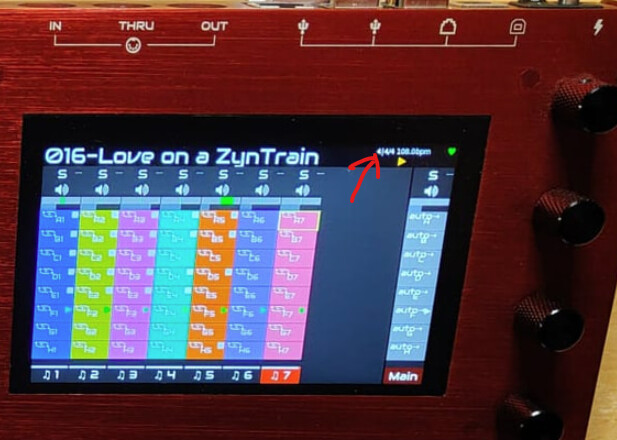

Can someone remind me what the 4| means at the top right in 4|4/4 … bpm?
I only see .| before the time signature.
There is a gui layout issue on lower resolutions screens. In mixer / launcher view there should be a display of time signature and tempo:
The tempo is in beats per minute with 0.1 beat resolution (which is the resolution we allow changes).
The time signature is actually the beats per bar. We always use quaternotes for this definition so not a real time signature, but the x/4 notation is easy to comprehend and gives us a good clue that it refers to time signature.
Before the time signature there is a vertial line separator and the current beat counter. This counts from 1 to the beats per bar, so a 3/4 time signature would see this counting 1, 2, 3, 1… whilst the transport is running, e.g. when a sequence is playing.
The beat counter is obscured on lower resolutions screens (as reported here) which I hope to fix later. (I see this issue with my V3.)
