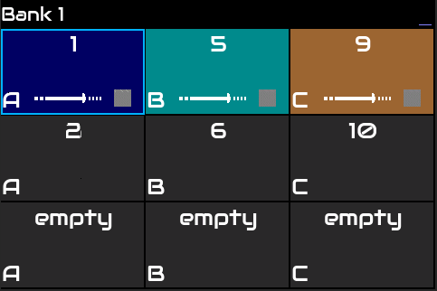

Hi,
following to fill up track pausing I created empty clips:
These I placed in arranger view to have the same starting point for all:
BUT, how can I start all tracks together?
Of course I can push some trigger buttons on Launchkey.
Otherwise I can´t imagine there is no easier way therfore.
I also can map CH#01 CONTROL_CHANGE 115 to trigger notes for special clips.<
I have the feeling to be at the very bginning of understandig the Zynseq…
:thinking:
Nomenclature again!
You have created three sequences, each with one track. For something akin to song mode you need to create a single sequence and add tracks to it. The Arranger view has a menu item called Add track.
ok, it works.
Thank you for your help.
:+1:
Adding Track was the hint.
I thought the same colour and the name are exclusive.
But they play together because of different instruments.
It is confusing.
That is what we need to reduce. Did you read the wiki guide? I thought it was described well but maybe needs some editing.
In summary, sequences in the same group are mutually exclusive. Each sequence may contain one or more tracks which all play together. Each track may contain zero or more patterns which may not overlap on a track. Each pattern may have zero or more notes.
