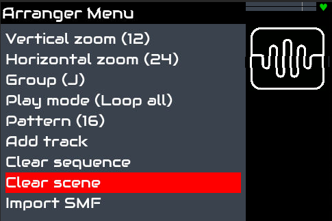

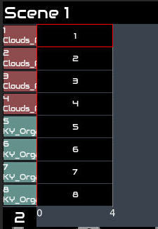

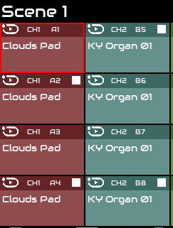

I have noticed one thing, when I use the ‘clear scene’ from the arranger menu. It says it will clear and reset to empty sequences. It doesn’t appear to do that, the arranger keeps the patterns as they were and the zynpad view does not change. I’m not sure if this is a bug…?
edit: Is this what it should do? Is it supposed to be the ‘reset button’ for the scene and makes everything default and empty again?
To add some more to this: I chose ‘clean all’ from the main menu. All my intruments/tracks are cleared, the mixer is now empty. When I go back to ZynSeq, it also looks empty (there are no names on ZynPad). However, when I go back into arranger view, all my previous instrument/track names are there. It seems to keep a ‘memory’ even after everything should be reset.
I tried a reboot to double check and the arranger view has now cleared.
But ‘clear scene’ isn’t doing anything…
This looks like a bug.
