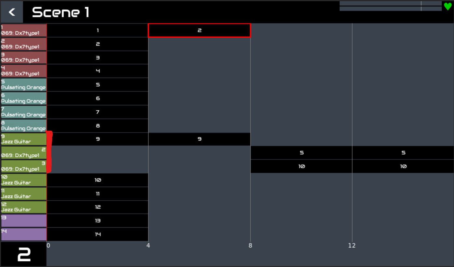

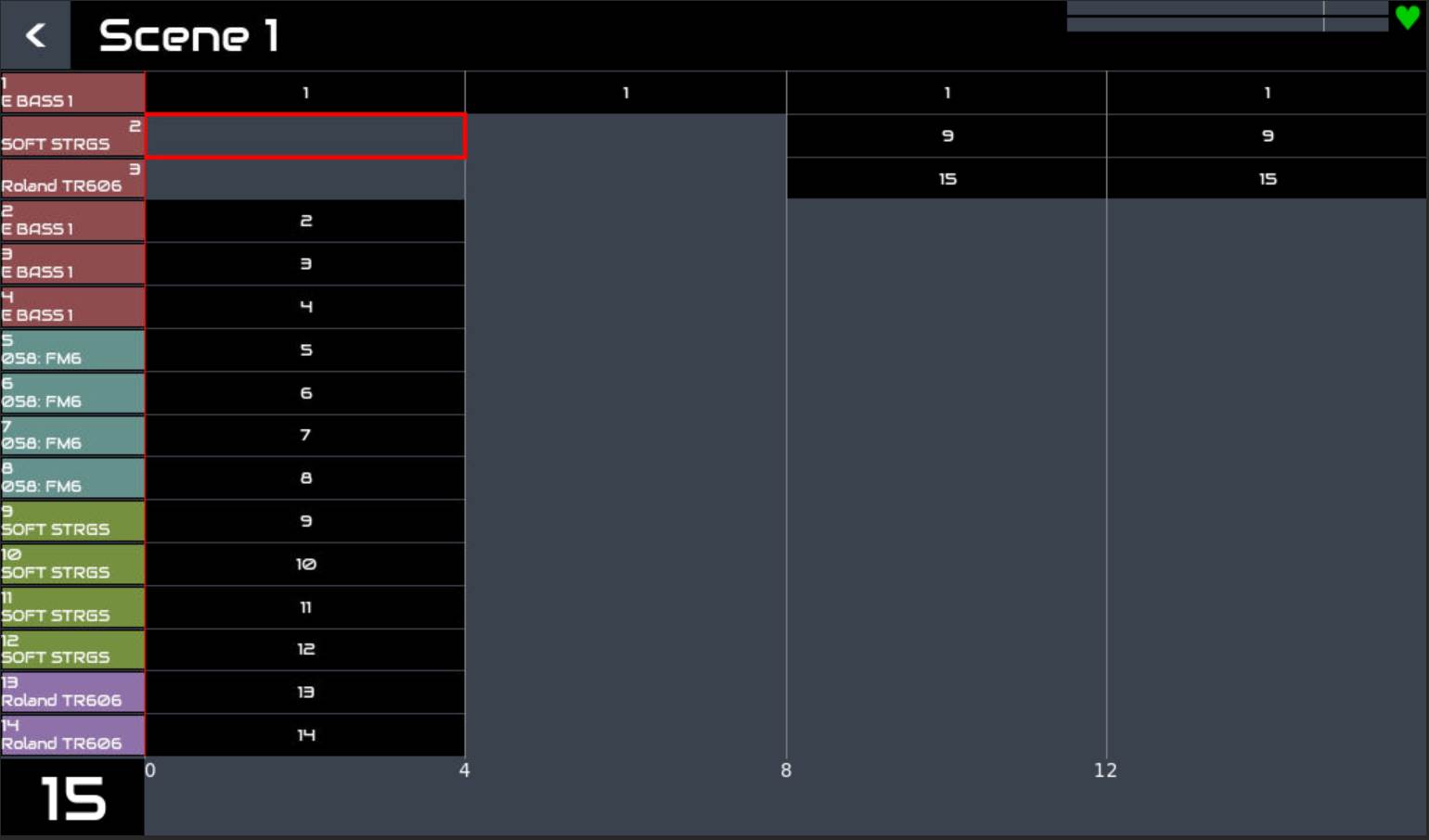

There’s a simple thing I can’t figure out with the arranger: once I add another pattern to the arranger (sequence 1 for example), how do I go back to the original pattern held at A1? Is it possible or does it become ‘locked’ until I remove the extra patterns/tracks? So below I need to remove track 2 and all the extra 1 & 5 patterns, then I can go back to edit pattern 1. Does that make sense? I just wonder if there’s an easier way to get around…

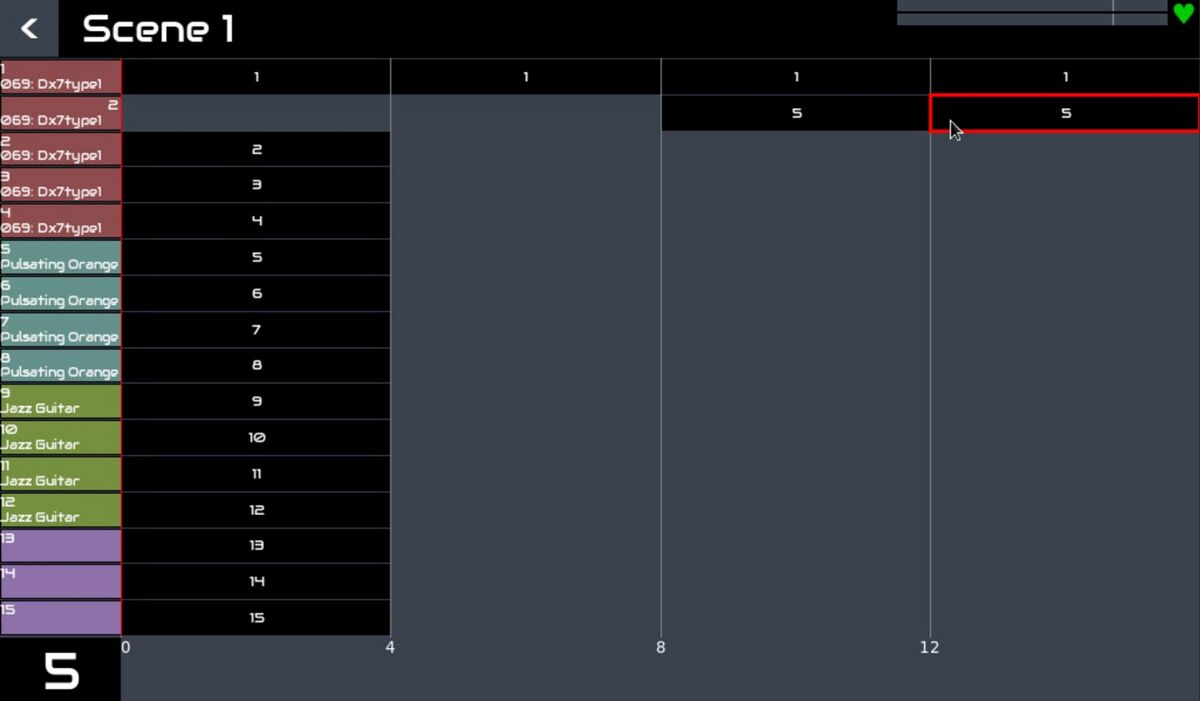

It would be great to see some adjustments to the label text on the sequences in the arranger mode to make things more clear. Maybe also a bounding box around an sequence zone once you’ve added more tracks to make it extra clear all of them are associated. The little numbers in the right of the label are easy to miss and they only show from track 2 and onwards. Another way could be to add a vertical bar across the tracks to indicate they are tied together.
Your first image shows 15 sequences, 1…15. (There are probably more scrolled off screen.) The first sequence has pattern 1 in bars 1 - 4. (There may be more scrolled off screen.) The second sequence has pattern 5 in bars 3 & 4. (Be aware that these are sequences. A sequence may have several tracks but your images show the default, one track per sequence.)
To remove a sequence, you highlight it and hit SELECT. This toggles the pattern at the current position. So, if you want to lose pattern 5 from sequence 2 bar 3, you would move the cursor (with arrow keys or encoders 3 (up/down) and 4 (left/right) then short press SELECT. If you want to add pattern 2 to bar 1 of sequence 1, you would move the cursor to that position, use encoder 2 to select pattern 1 (shown in the bottom left of the screen) and then short press SELECT. Please explain any shortcomings in the user documentation that describes this.

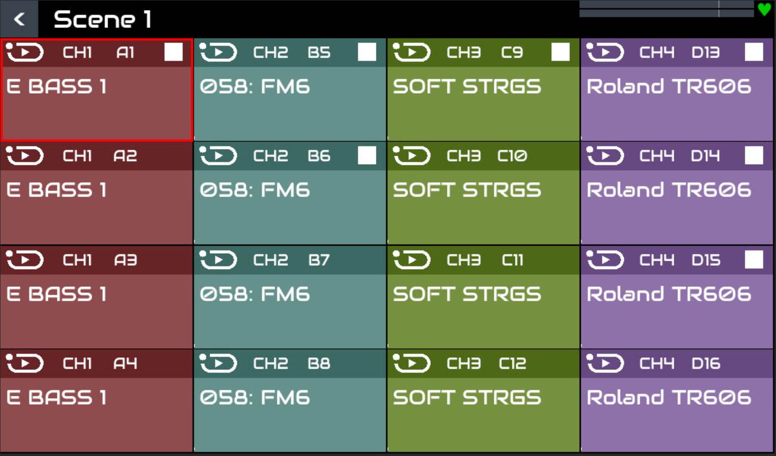

If I’m in Zynpad view, and there’s a sequence sitting underneath A1(below), when I bold-press into that pad (as I would normally do to get to the pattern), it takes me directly to the arranger view. I thought I had to delete the collection of patterns+tracks from the sequence to get back to the original pattern made in A1. The way to get there is to bold-press a pattern inside the arranger view. So it’s accessed the same way, just one step deeper and it’s no longer available from Zynpad directly.
