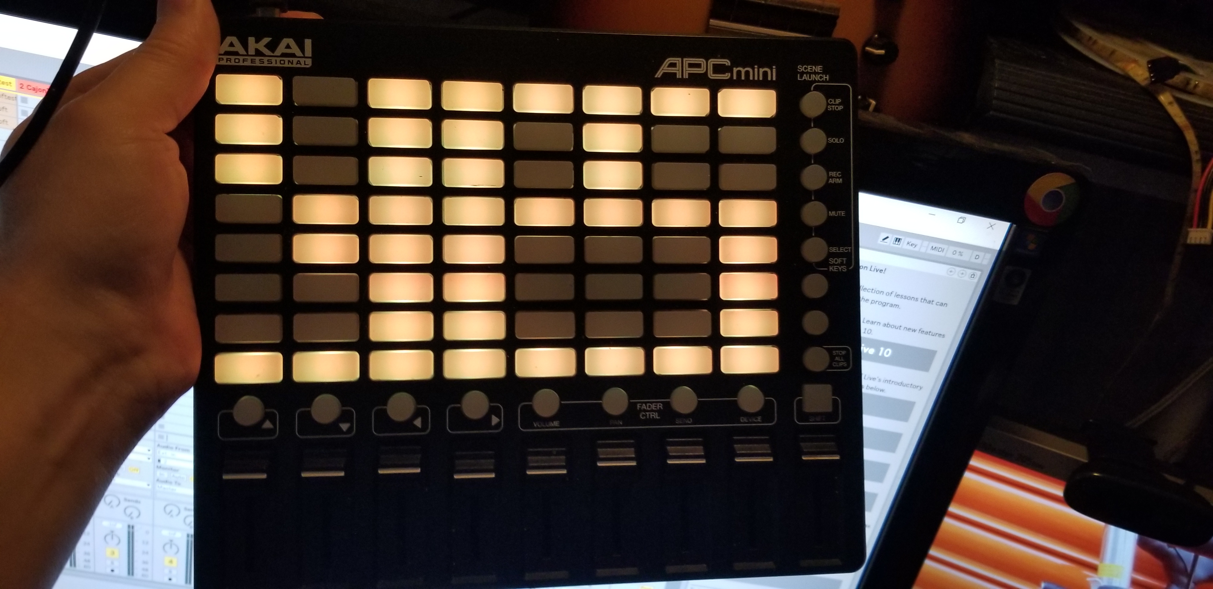

“Live launcher” - do you mean like a jingle player where you hit a button and a sequence plays? Hitting it again will re-trigger the sequence from the start? Would we want it to have the option to play whilst a key is pressed and stop when the key is released and have an option to trigger on key press and ignore key release?
I see, so some sequences are configured to loop whilst others configured to play whilst pressed. I can’t see it in this interface but it may be advantageous to allow more modes:
Single shot, always play to end of sequence
Single shot, play whilst pressed stopping at end of sequence or when released
Loop, toggle on / off, stopping when off
Loop, toggle on / off, playing to end when off
Loop whilst pressed, stopping immediately when released
Loop whilst pressed, playing to end of sequence when released
First and last could be combined to a single mode, i.e. always play to end of loop and repeat whilst pressed. I would also want to decide whether triggering whilst a sequence is playing would retrigger from start or stop the playback. Within the GUI this could all be represented with icons and it could all be triggered by MIDI note on / off (although which channel to use is open to debate - the master channel is already used for CUIA).
