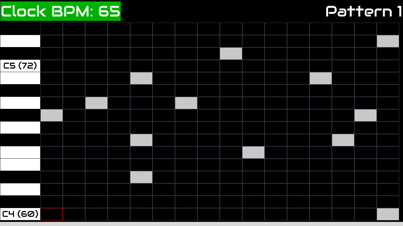

The top left encoder opens up the function menu but the encoder doesn’t change the value as I believe is the correct operation. (The encoder works on parameters in layers )
back goes back to function select.

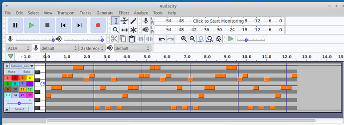

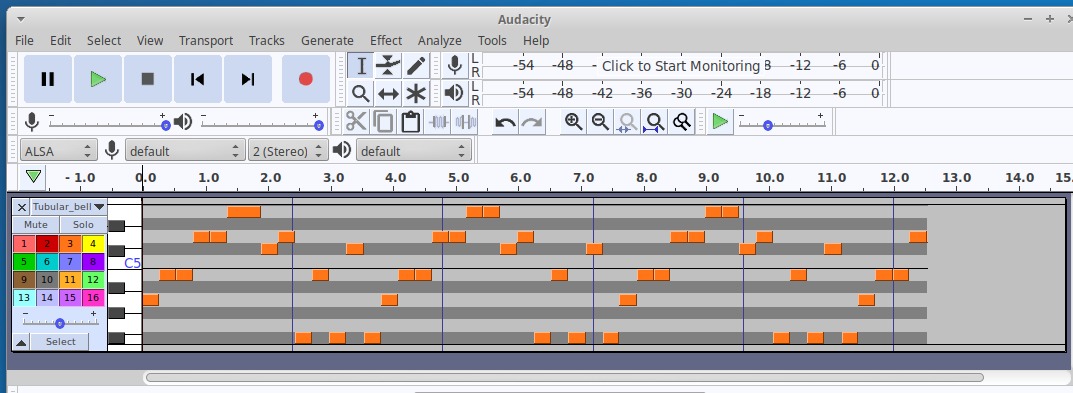

Some very regimented Mike Oldfield. Sequence running on zynthian-ceed.local (the dev environment) & played on zynthian4-steel.local, the synth in a hifiberry case using qmidinet, with the GuI driven by vnc . . . .

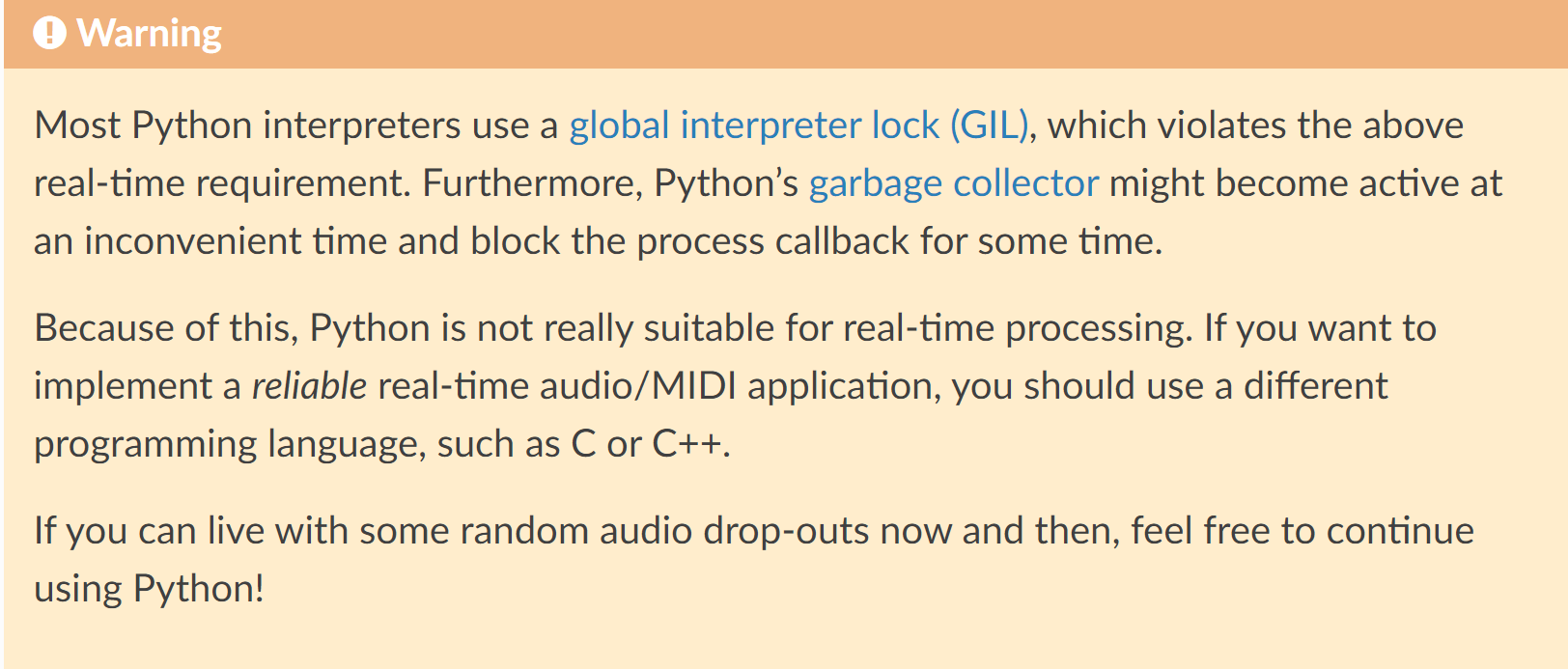

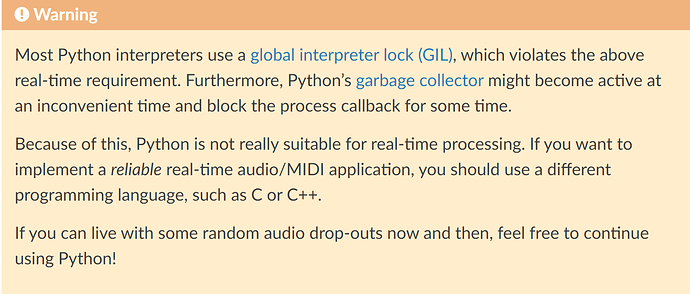

I’ve had the Oldfield playing for a while now and it does miss the occasional note, but you probably know that. (teeth grinding mutter at python . . . )
@mheidt I wrote a RIFF encoder and decoder from scratch. When I publish the code (hopefully this week) you will be able to see. It is fairly simple, just write / read header then write / read block data. I could probably add more error handling and I think I my code currently expects blocks in prescribed order but that is a requirement of this implementation.
@wyleu yes! Python is the main cause. From the Python JACK library docs:
I have written a c++ wrapper for the c jack library calls which is far more performant. Hopefully available for derision later this week.
There are ways round the GIL but that is certainly The C based Python’s achilles heel for a lot of problems.

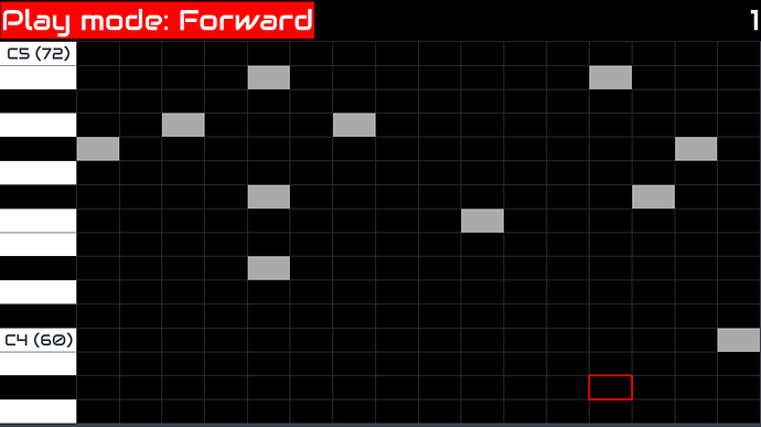

Hi Riban,
layer encoder allow me to navigate trough the different items menu but once an item is selected (saying tempo) I can’t make any change.
I can confirm that problem. Also, the step view can scroll up and down, but not sideways. With the default sequencer settings, that means I can’t see most of the sequence.
That being said, great work, @riban!
Hi
  • Layer encoder selects menu item.
  • Pressing Layer button should then toggle to allow changing value.
  • Layer encoder then allows selection of different values.
  • Pressing layer button or back button should exit menu value selection mode.
  • Snapshot button should toggle play back.
  • Snapshot encoder allows selection of note.
  • Select encoder selects step.
  • Select button adds / removes note.
The whole sequence is displayed horizontally. There is no horizontal scroll or zoom.
There is vertical scroll and zoom available. You should be able to see the whole timeline at all times.
That’s just it. I can’t see the whole timeline.
