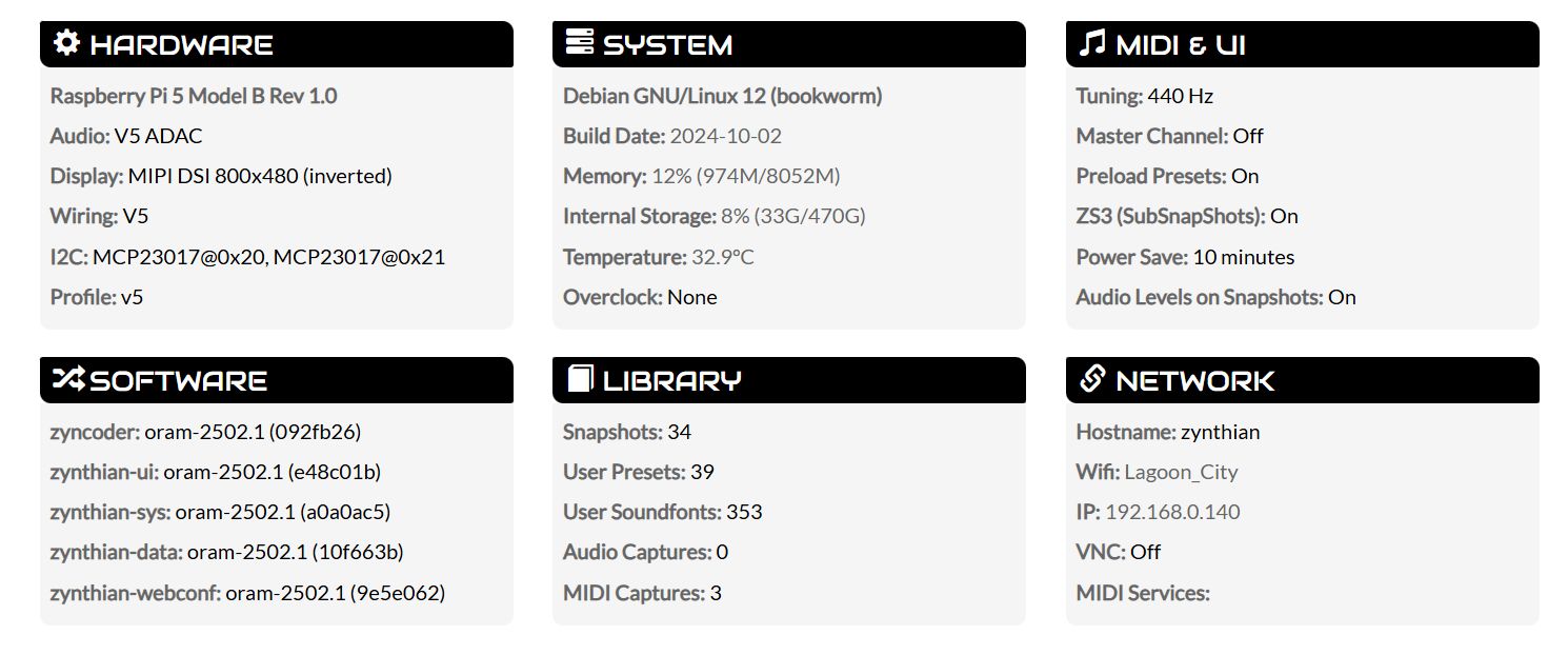

The issue I’m having is that, with default sequencer settings, patterns won’t play - I get a yellow play icon when I try to launch a pattern from the grid. This happens after a hard reboot with nothing connected to the MIDI inputs. The only way I can get a pattern to play is to connect an external sequencer and use that to send a transport start message to the Zynthian. That starts any patterns that were already queued to play (yellow play icon in their grid cell), but if I try to start any other patterns, or if I stop a pattern that’s playing and try to start it again, they also stay queued (yellow play icon) and never actually start unless I stop the external sequencer and start it again (to send another transport play message). Stop messages from the external sequencer don’t seem to affect anything.
I’ve been doing most of my sequencing externally so I haven’t used ZynSeq much, but I didn’t have this issue before I updated to Oram stable 2502. I’m probably missing something obvious that changed for this version, but I haven’t been able to figure it out yet, any help would, well, help.
