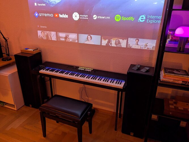

This is what my living room setup looks like.
The stereo system is connected to the Zynthian V5. I usually have it running 24/7 and it allows me to turn on the S88 Mk2 Keyboard anytime and start playing.
I also installed librespot on the Zynthian, so I can use it as a Spotify Connect device and listen to music on demand using my phone.
I have Android TV running on a RPi4 (works quite well) hooked up to a projector.
For watching movies or playing games (using Moonlight/Artemis) I found a great solution to get the audio from the Android TV to the Zynthian: scrcpy. The newer versions allow you to easily stream audio only using wireless adb. Works really great and is low latency enough for movies/games (~30ms buffer is fine with my setup).

That is an unreservedly amazing room arrangement @Kosro!
I’m curious about a couple of questions:
  • Are you using a ceiling-mounted projector? Do you get a decent pixel resolution and image brightness on the wall?
  • How do you handle the uncompromising line-level output of a musical instrument (Zynthian), on the signal chain of a stereo system with amplifier and passive speakers? Since these appliances are designed for the carefully profiled and limited spectrum of recorded audio signals, it is notoriously tricky to employ them with instrument-grade direct audio. Typical dangers are for the speakers’ cones and the final amplification stages, depending on nominal peak wattage and impedance.
Cheers :rainbow:
Thanks :))
It’s a ceiling-mounted ViewSonic PX747-4K, but it’s incredibly loud when the pixel shift is enabled, so we just use it in 1080p. Then it’s completely inaudible over low volume music/movies.
1080p is totally adequate for our purposes, and the RPi4 would die five times if I so much as think about running Android TV in 4K ^^
(a good heatsink alumunium case is key even at 1080p)
It’s quite bright at 3500 ANSI Lumen, but I still lower the blinds a bit when the sun is out.
No problems with the audio levels so far. The volume ranges seem to fit together quite nicely (Zynthian Instruments, Spotify Connect, Android TV scrcpy audio, builtin Amp bluetooth).
I’m using a ridiculously tiny amp, but it get’s the job done. Supposedly does up to 150W per channel, the speakers are rated up to 200W.
I believe this tiny amp would blow up first, before anything serious happens to the speakers.
The amp is set to ~10% at most, much higher would shatter our neighbours windows.
I have it plugged into the headphone output, which had it’s output level lowered a bit in the Zynthian settings.
