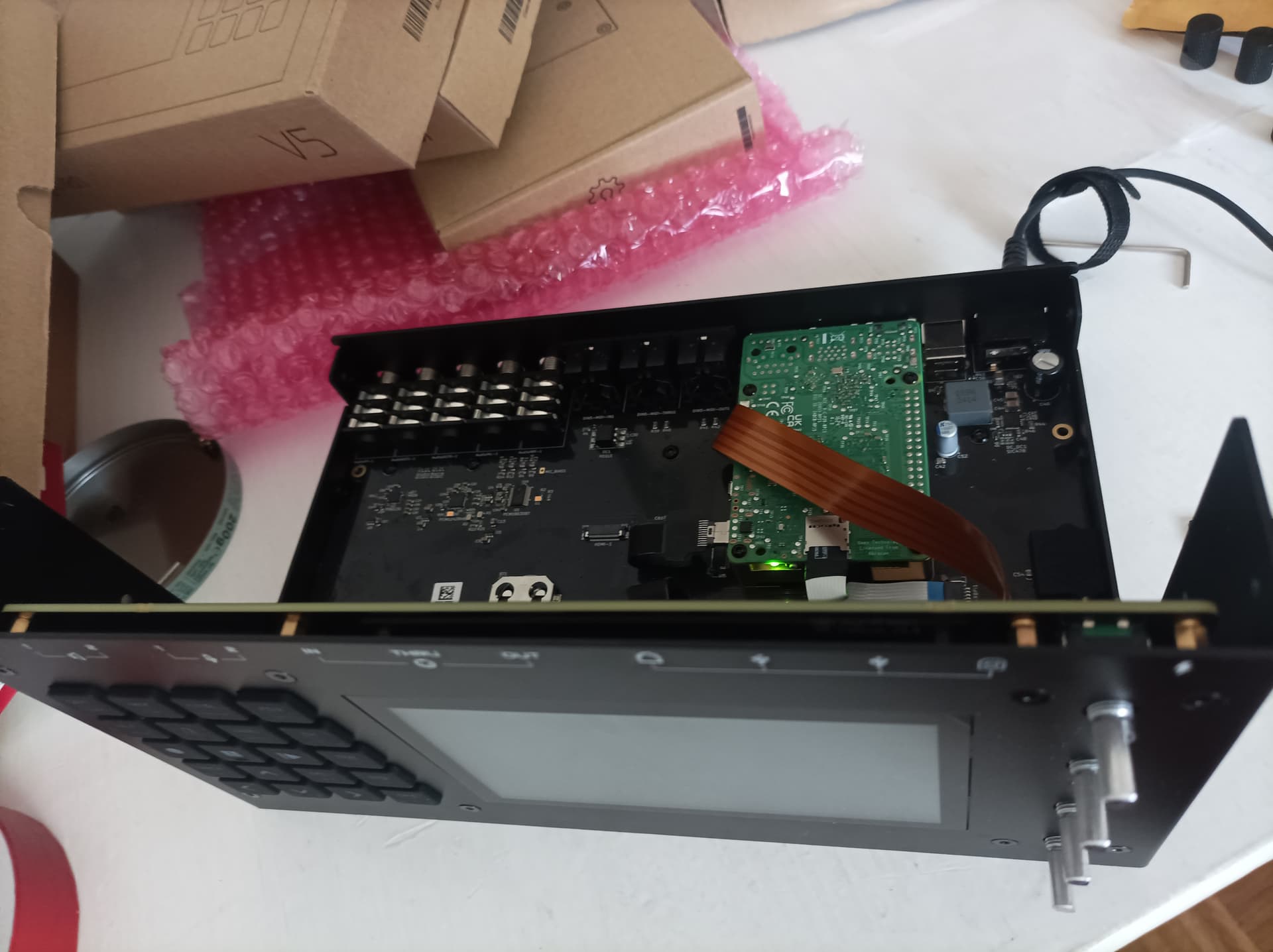

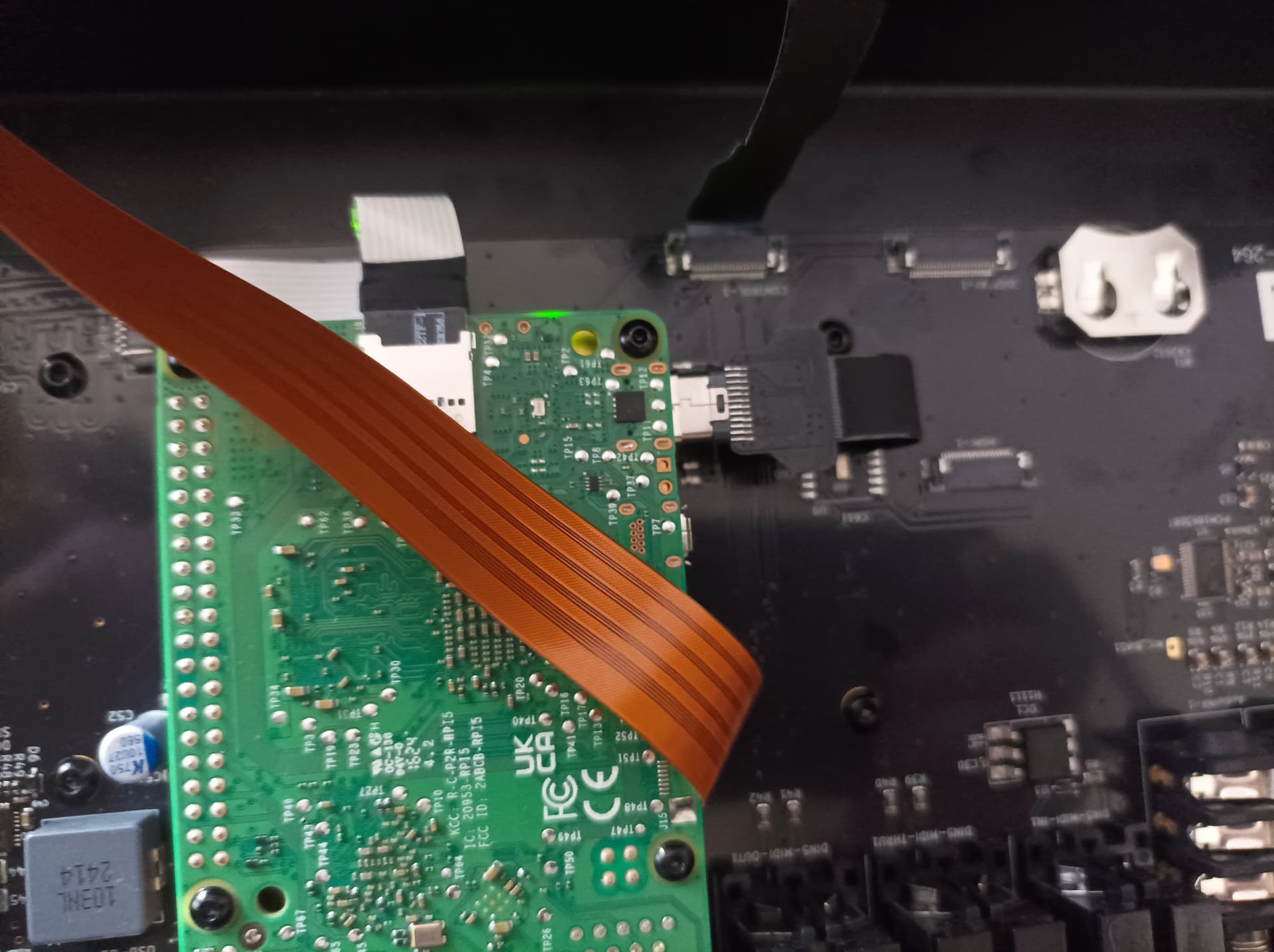

I have followed tutorial and assembled my Zynthian V5.1 box but when I plug in electricity nothing happenes with screen and buttons. Rbpi is on (as shown in the pictures) and I have tried connecting midi keyboards to use Zynthian as PSU - it works.
Pictures:

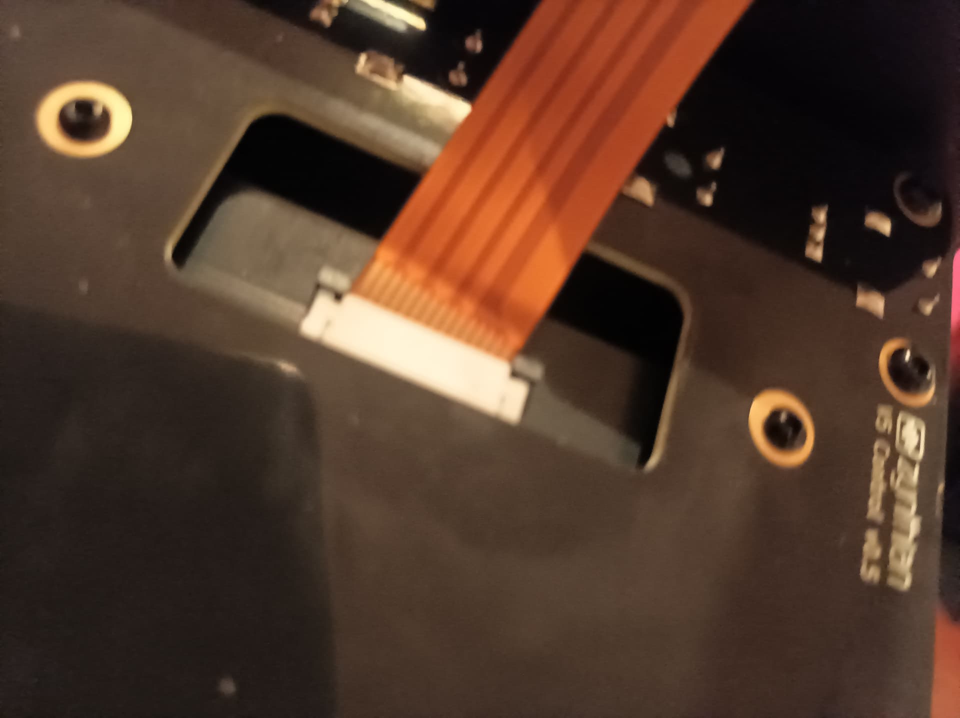

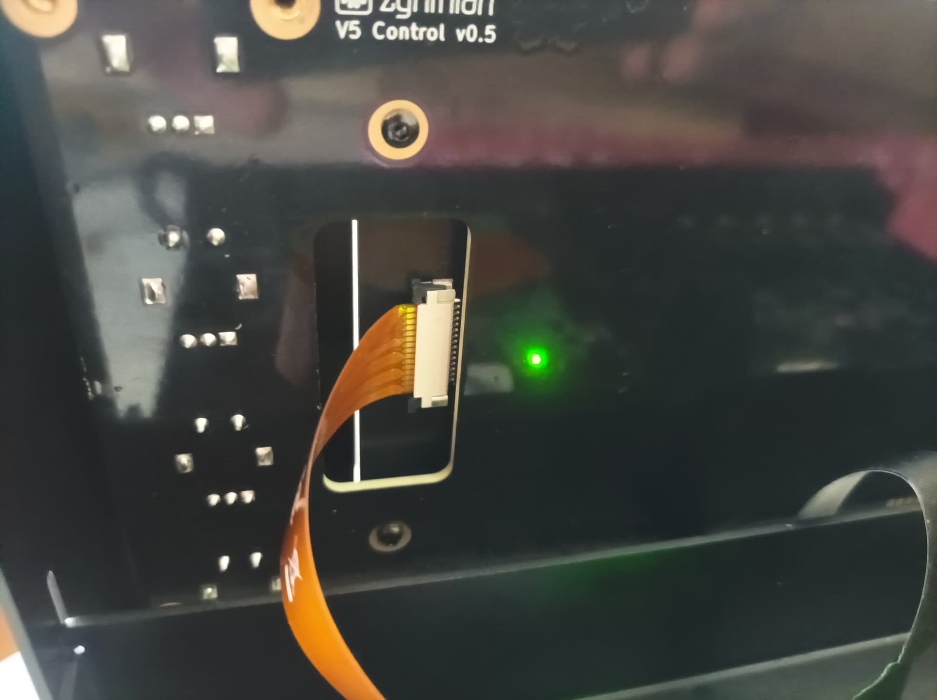

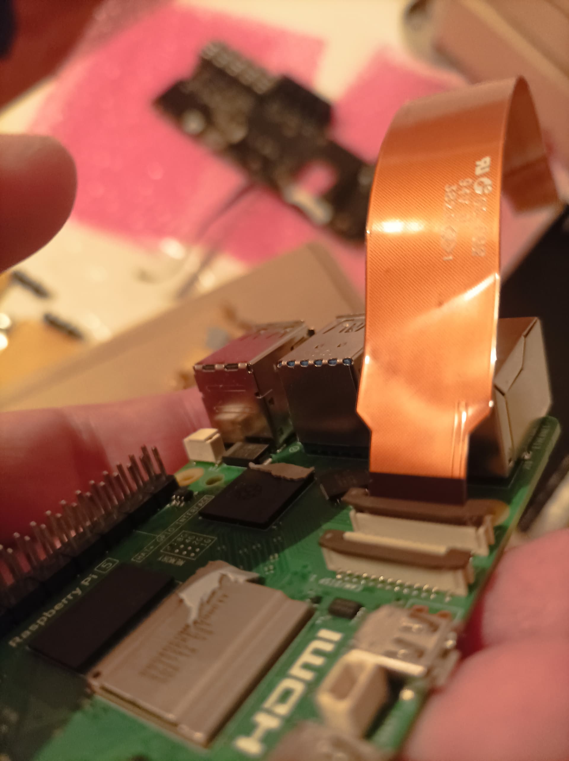

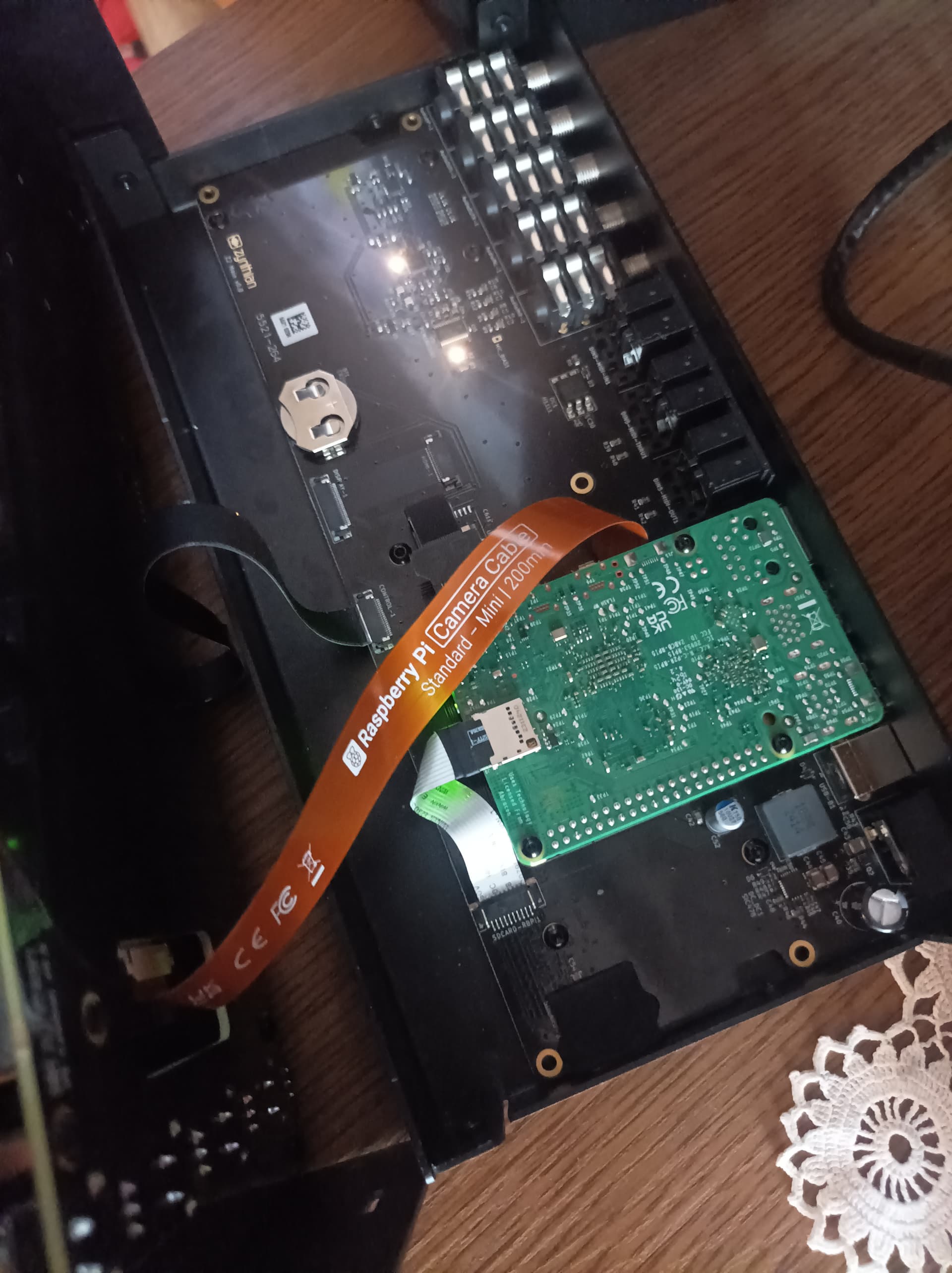

Are my cables properly connected?
Or it has to do with different display cable? (My kit didnt include display cable :man_shrugging: so I used rbpi camera cable)
Rbpi is on, zynthian works as PSU but nothing happens on the screen and buttons.

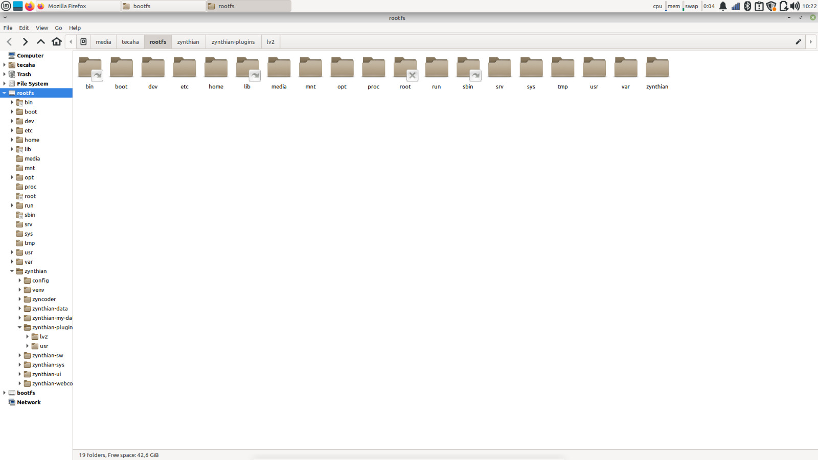

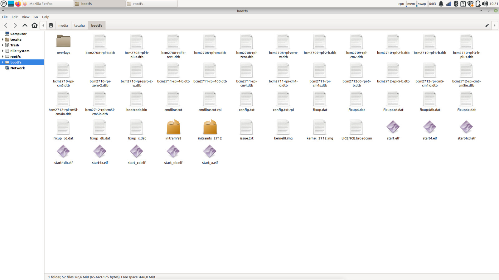

I also tried inserting sd card directly in rpbi, nothing different. (Latest stable image flashed properly on sd card)
Sd card content (Sandisk extreme pro 64GB)

Hi @tecaha !
  1. Please, re-burn the SD-card with a fresh image (lastest stable).
  2. Re-check all connections, verifying orientation, insertion, etc.
  3. Insert the SD-card in the RPi directly to be sure.
Then boot and check the RPI5 LED status. You should see the green LED blinking. If the green LED is solid, then something is not right with your SD-card / image.
If it boots but you see the error screen or nothing at all, connect your zynthian to the network and try to access from the webconf terminal. Then send the output of this command:
cat /root/first_boot.log
to see what goes wrong with your boot.

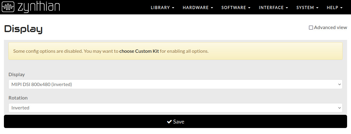

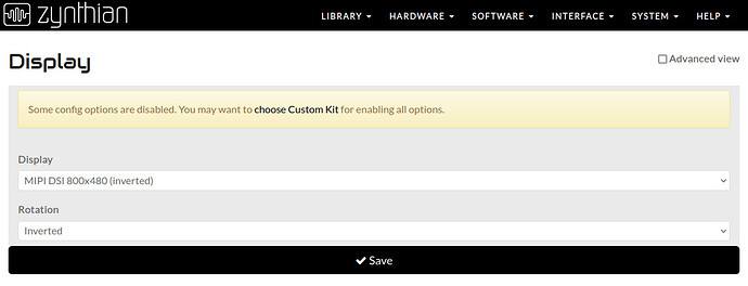

Does display/buttons related problem got anything to do with this maybe?
This log seems right. perhaps display is not connected correctly?
could you send the output from this:
journalctl -u zynthian -f -n 200
regards
I asked Google: “is raspberry pi camera cable interchangeable with display cable?”
and got:
No, Raspberry Pi camera cables and display (DSI) cables are not interchangeable. They have different pinouts and connector types, and using the wrong cable can damage the Pi or connected devices. The camera cable is designed for MIPI CSI communication, while the display cable is designed for MIPI DSI.
I checked few times on connection, might be the cable :person_shrugging:

Yes, the camera cable is the same as the display one (except for the one for the Pi Zero and Compute Module I/O Boards which use a smaller connector)
I tend to lean on the other side now… But is it connected with button not lighting properly problem?
I don’t know, I just noticed in your original post you said that you were using a camera cable instead of a display cable because your kit didn’t come with a display cable, and nobody has replied about that specific point.
I dont know really… just hope that hardware is not damaged :grimacing:
i would bet display is not connected right.“No screens found” is quite clear about it. i would double check display cable connection, both sides
I tried all combinations, didnt seem to come further than this state.
I’m going to call it a day, at this point I’m scared that I might break something :person_facepalming:
Is this correct cable orientation? (Dissassembled)
Facing away from Ethernet port.
I dunno :person_shrugging:
Thank you for your time guys!
Are you trying with a fresh burned SD?
Autoconfig script only runs on first boot
The camera cable is different to the DSI cable. The display will not work if you use a camera cable.
Of course. Display cable is different to camera one. if some part is missed from the kit, you must notify and we will send ASAP. Please, be patient and don’t use any part unless you are 100% sure is the right one.By using wrong parts you risk to break something and worsten things.
BTW, have you double checked that the display cable is not in the screen & bits box? It should be there.
Yes I have checked everything for display cable, nothing :person_shrugging:
Ok so it seems that cable is the wrong part. I just hope that camera cable didnt damage any of the hardware.
Hope I recieve display cable soon and continue building Zynthian!
Thank you guys alot!
