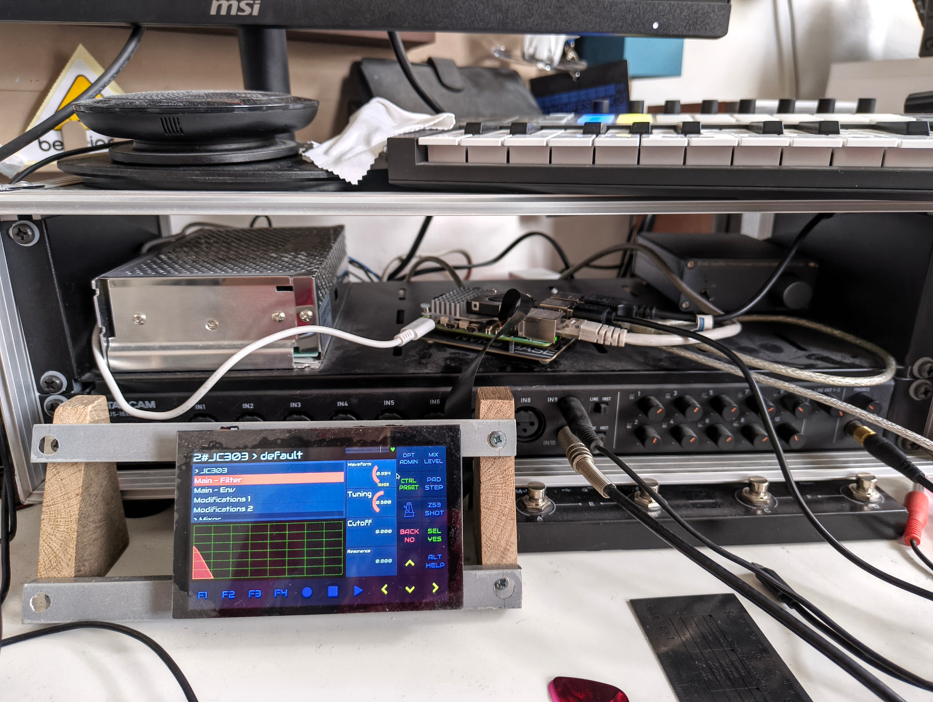

Very much a work in progress but I am putting mine in a 3U flight case. Mounting the screen has been the biggest challenge.

The screen pretty much sets the style of any enclosure so that is probably the best starting point. The secondary consideration is access to the pi connections so the pi tends to end up in the corner of boxes.
