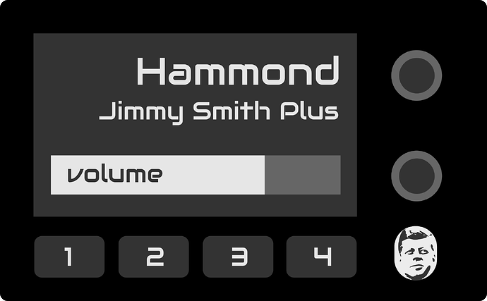

The idea is to develop a more simple, specific and highly curated User Interface for keyboardists. We would keep all the core functionality inside, but only a subset would be available from the UI, that would be extremely simple and very stage-focused.
At the moment, only ideas in my head and this image:
This is only a bare sketch, but good the get the concept:
  • No mixer UI
  • No sequencer
  • No MIDI chains
  • Very basic routing options
It would be a step backward, keeping all the power but using only what is needed for playing keys in the stage.
The typical JFK user wouldn’t be the current typical “full” zynthian user. We want to reach less techie users: more music and less options!
The JFK would be a kind of “zynthian snapshot player”. Standard zynthian snapshots would be loaded and presented in the JFK UI. We could have several options to interpret the zynthian snapshots:
  • Chains would be presented as instruments. Each instrument would have access to synth banks and presets.
  • ZS3s would be used to create a tree of instruments with presets (the details in my head).
  • Regarding parameters, we would use “chain controllers” for showing a subset of all available synth + FXs parameters.
Creating new snapshots with JFK would be limited because much complexity will be hidden from the UI. Having a set of highly curated snapshots is a key point for JFK. For instance:

Current zynthian devices could run JFK or the full version. Indeed, we could have both in the same SD image and choose what to run from the admin menu (or from a boot menu).
A new hardware standard, more simple, would be defined. I play with the idea of using just 2 encoders and 4 buttons. This would allow to run JFK in all currently existing devices without problem.

I don’t think the beatbox functionality interferes with the keyboard expander and there is no plan to reduce the keyboard expander functionality.
I laughed when I saw that JFK would remove (hide) much of the functionality that I implemented. Maybe it should be nicknamed “sin riban”. :rofl:
Sounds like a Zynthian Live.
:innocent:
Not remove, just hide from UI. The underlying power would be there available to use when needed.
That’s the idea. A zynthian version for keyboard performers totally stage-oriented.
As i told, the targeted users would be quite different to current crowd. Less technical-skilled, more “pure-musicians”. Of course, there would be an intersection, but as @riban said, avoiding the sequencer is easy, just don’t open the zynpad/launcher. It doesn’t interfere the keyboard-expander functionality. It’s the “dawish” style what i think could be intimidating for the average keyboard player. Many of them want to avoid the PC, but they don’t want to replace it with a micro-DAW, and here is where JFK enters with a DAW-less spirit. The DAW engine is still in the basements, but not presented as such. Instead, i propose an instrument-oriented UI. Something that most keyboard players would accept in the stage. The JFK competitors wont be Ableton or Akai MPC, but Nord Stage / Electro keyboards :wink:
Of course, if you are a zynthian user and want all the power and options, you can keep using the full UI. We don’t plan to reduce the keyboard-expander functionality. Indeed, we would keep improving it as it’s the core of zynthian project.

As i told, dear zynthianers, most of you are not the target for JFK, perhaps “some of you”, but not “most of you”.
Of course, it would be fantastic to create a custom UI for each use-case, for each user, but this is not possible, sorry. We want to develop UIs for large-enough user groups. So currently we have created a hugely customizable system with a lot of options and possibilities. The current Zynthian UI is a micro-DAW that can be configured to solve a zillion use-cases and this is not going to change. In the contrary. More power, more options more use-cases. This is the path to follow for the Zynthian UI.
JFK is just the opposite. If you have a special use-case, it’s not for you. If you want to play “a la JMJ” or like to do “a-la-Vangelis” performances, JFK is neither for you. What you want is the full Zynthian UI (well, indeed you would like a customized UI for your specific use-case because you know exactly what you need and how you want it, but this is simply not possible unless you want to develop it by yourself).
JFK is for the average keyboard player (a large-enough user group with a common use-case). For those who enjoy playing a Nord Electro keyboard, those who want to play one instrument at once and don’t know or don’t want to remember what a MIDI channel is. You select the instrument & preset, you play. You may want to adjust the volume and a few, well chosen, parameters. Nothing more. Of course, there would be some extra options, like transpose, key-split and perhaps multi-timbral basic adjustments, but not much more.
Never. You can bet!
Always open, always free. JFK too, of course!
Typical JFK target wouldn’t want to create snapshots.They would use available snapshots (saving the user adjustments, of course). The 4 JFK buttons are thought to save/restore user presets (ZS3s).
It’s expected that the intersection user group would help to create “curated JFK snapshots” and share with the rest. I would create an initial set.
