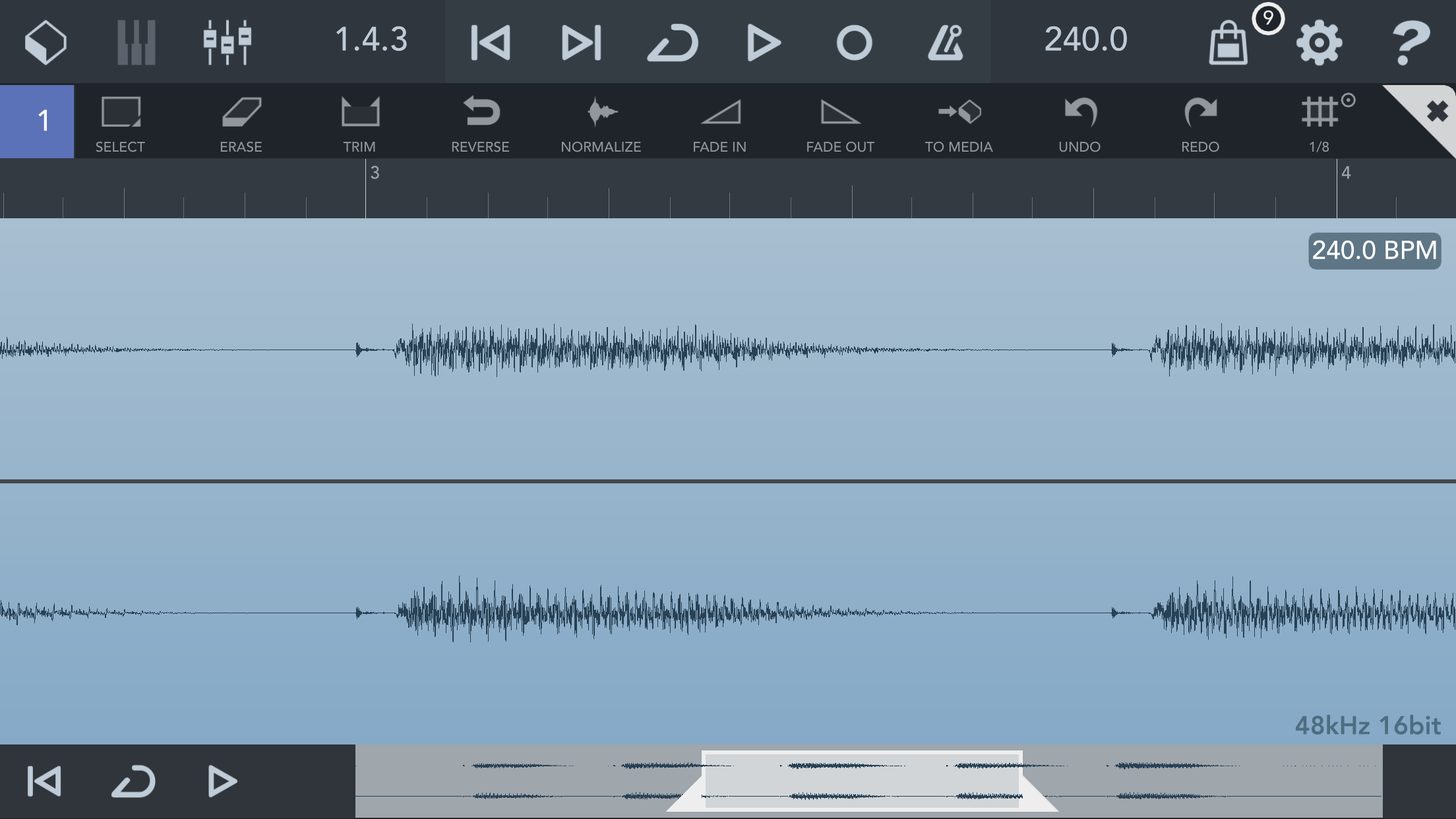

Hi, did some checks by recording:
  • a percussion sound from my stage piano
  • notes from Zynthian’s Pianoteq
    that are triggered by the same midi note.
In the attached waveform, you can see the peak of the percussion sound and the onset of the piano sound.
With 240 bpm, every beat is 250 milliseconds, every 16th note is 62.5 ms. So the latency of the piano sound seems to be around 30 ms. Unless I am forgetting something.
Is there any way to get this down? I had planned to use the Zynthian for Pianoteq, but at the moment it cannot really be used for playing music with enjoyment, except for mellotrons and string sounds :wink:

You describe triggering from a sequencer. Will you please describe the physical configuration, e.g. what is the sequencer? How is it connected to each device? How are the audio from each device connected to your recorder? How is that audio routed to the recorder? It is difficult to see the difference in timing in your picture. A more zoomed view with timing info and a vertical marker at start of sound may help.

The recording was made by running the Zynthian and Stage piano into a mixer and then recording it. Any recording latency would be identical for both devices. So I think the test was realistic.
I have the official Raspberry Pi 4 power supply, not sure whether there a better ones.
The “sequencer” is my finger pressing a stage piano! :wink:
This triggers both the percussion sound of the stage piano and the Zynthian running Pianoteq.
Both outputs go to my mixer/audio interface.
The waveform is the sum of the two sounds. The first peak is the percussion instrument - really short - then the piano waveform. The distance between the peaks indicates the latency.

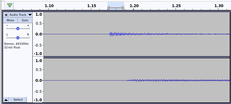

OK. This is the latency on mine both channels panned left and right. Stage piano Perc on the top channel, Pianoteq on the bottom. They start at 1.17 and 1.19s respectively. A latency of 20ms? TBH, I can’t hear it. They sound instantaneous to me.
Are you listening in phones with channels left & right?

Yes :slight_smile:
You’re dead right about feeling, I should have said it “feels” instantaneous.
I just did a quick test and see similar results.
