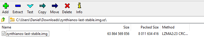

After all my issues with internet radio and freezing issues, i decided to download the current ORAM again from the wiki-pages. When done and unpacked, it turned out to be a 62GB large image file. On the wiki it says that a 16GB card would suffice, but i recon (unless something is really wrong) that this is not true any more? :slight_smile:
I can of course go and purchase a 64/128gb card tomorrow, but i got curious to learn what are the requirements atm?

Ups!! It seems there was some issues with the process that generates the SD image.
I will fix the SD image size ASAP
Thanks!!
It’s already fixed.
A new image has replaced the faulty one and when uncompressing, the size is the expected one.
