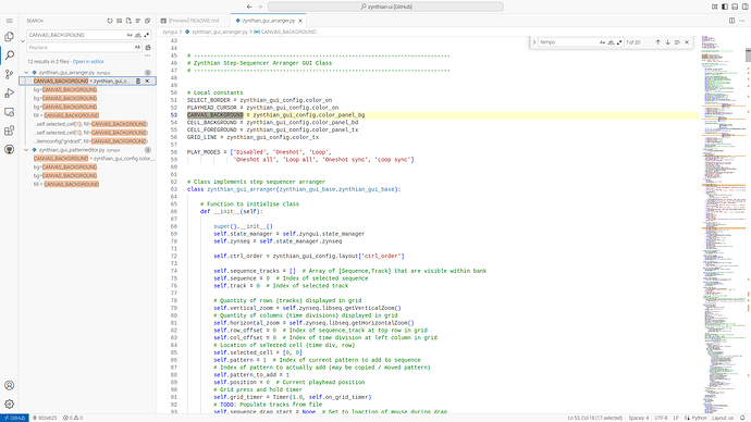

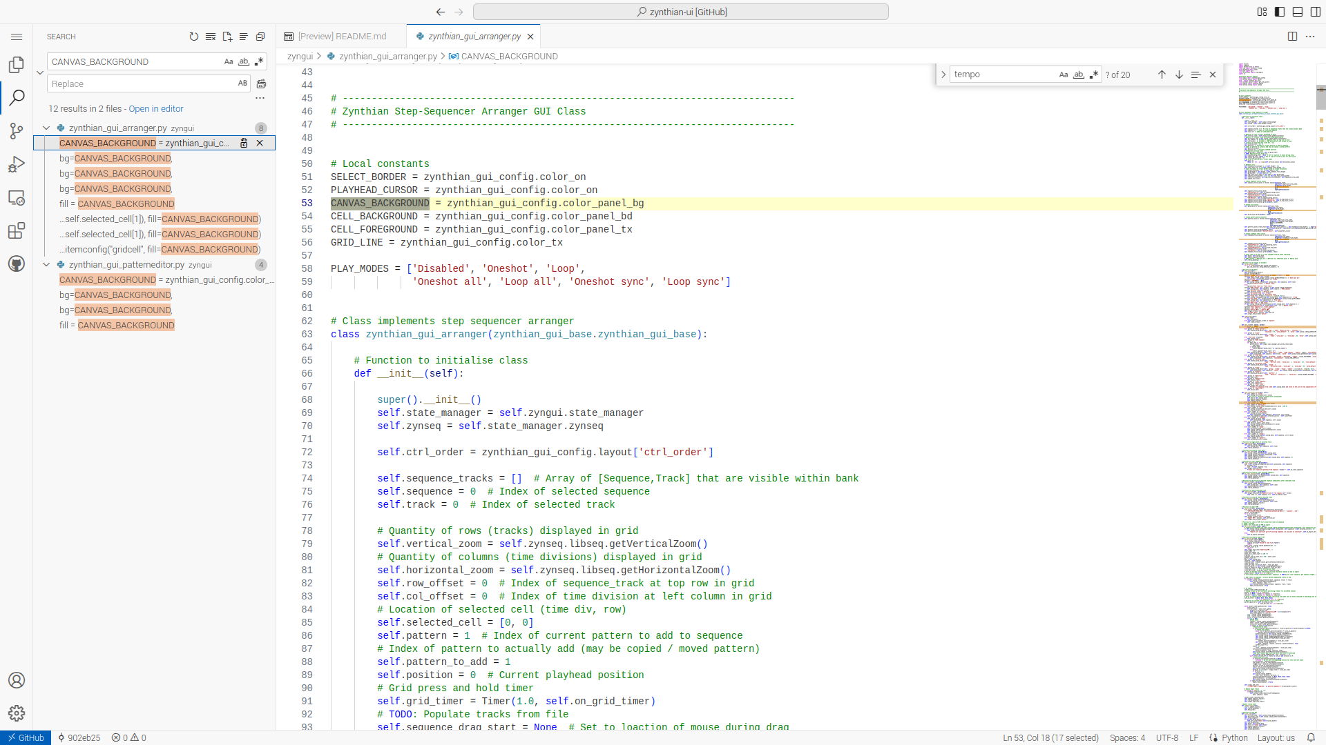

There’s some colour cross linking to zynseq here . . .
Well, this is quite cryptic, but at least it’s a starting clue… :alien: :sunglasses:
I think you posted the wrong picture!
Oooops yes I did…
Update,
I don’t know what you are talking about…

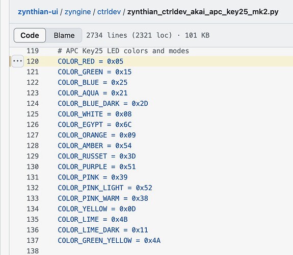

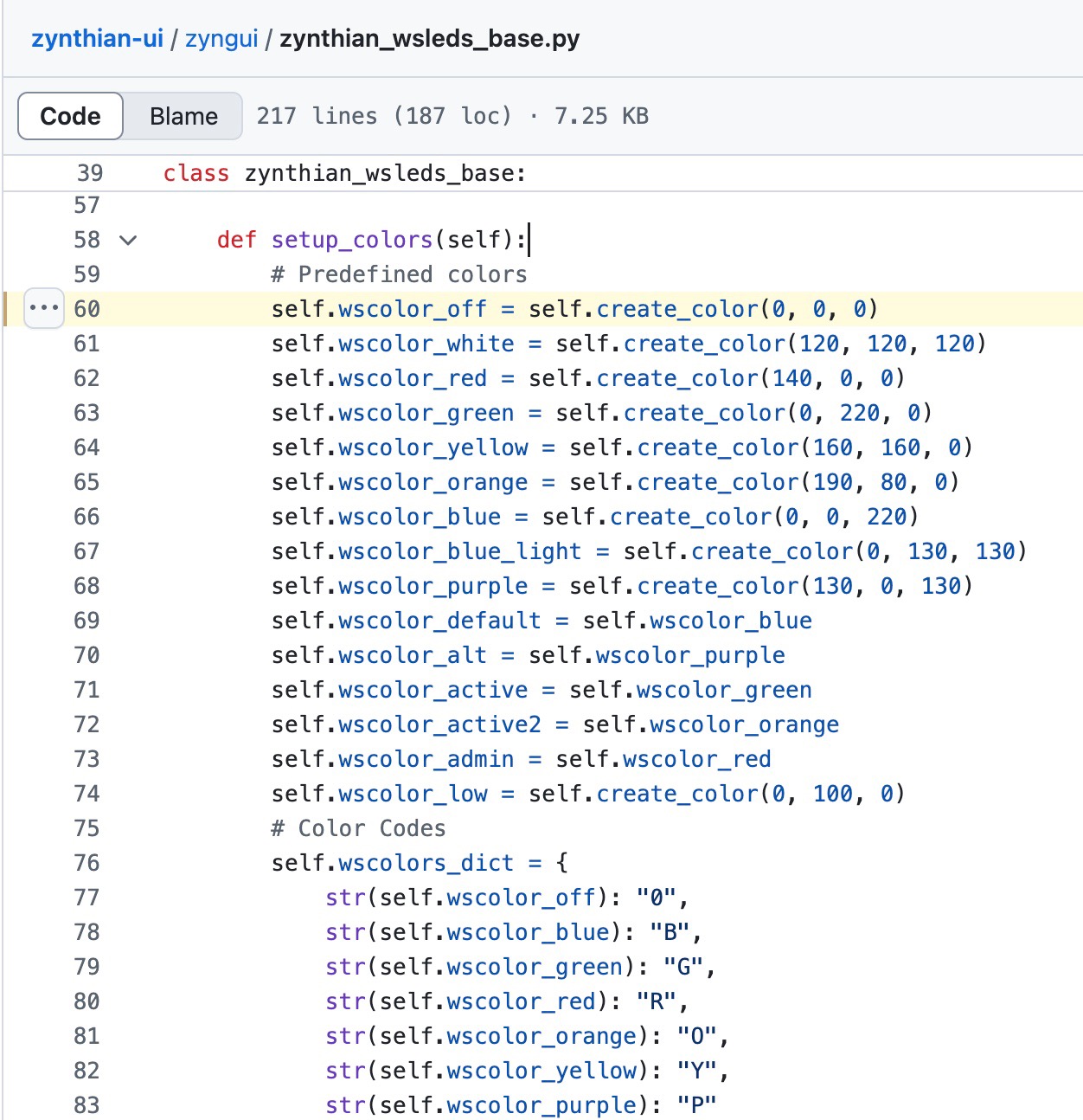

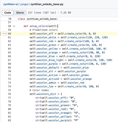

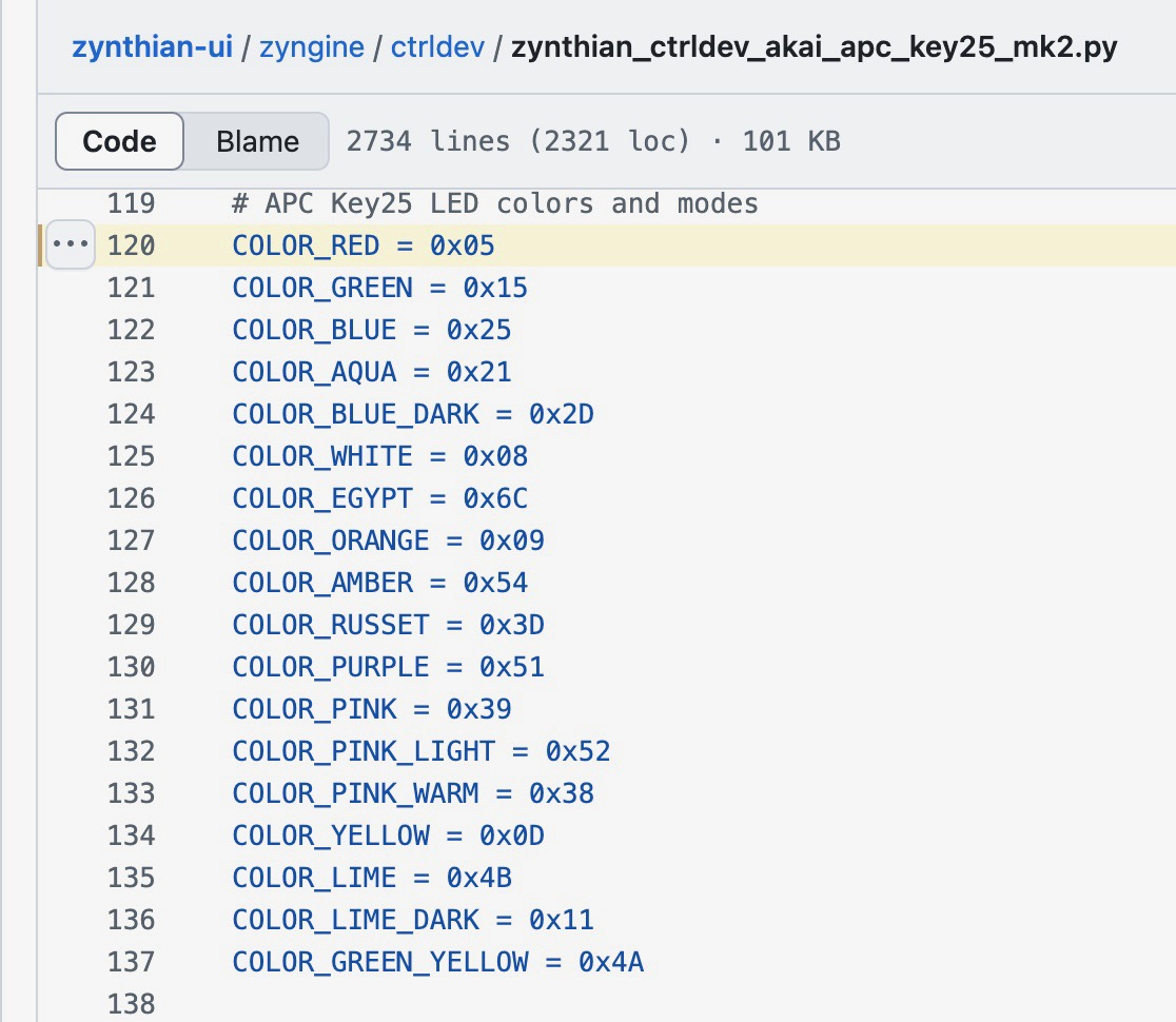

Thanks @hannesmenzel, for pointing me at potentially relevant parts of the Zynthian code in GitHub… :man_detective:.
It seems that some workings of the Zynth UI innards are being kept shrouded in a certain - let us say - amused secret… for the time being :wink:. Anyway, I have widened your search, for any source code results that include the key “color”, and have found a couple of interesting places, especially one related to the pad colours of the Akai APC 25 grid controller. Given some obvious chromatic resemblances, might it be that the listed hexadecimal RGB colour definitions do contain the hardcoded hues of the Zynseq page…?
Regards :slightly_smiling_face: :rainbow:
