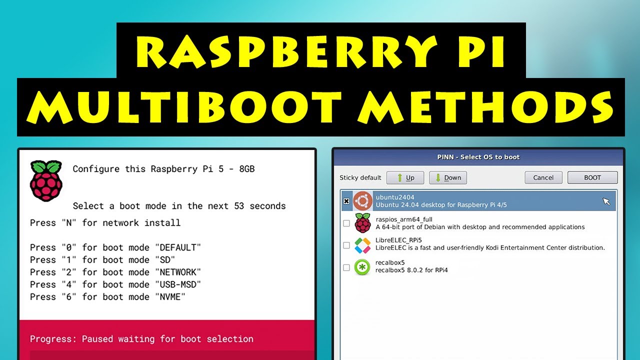

I am playing with the idea of installing on its SSD drive both Oram/Vangelis and Raspberry OS (or even possibly Ubuntu). The pleasurably talkative guy in this video mentions a sleek solution, with a multi-OS launcher called PINN, about midway in the YouTube clip.
I wonder if Zynthian would tolerate by design a similar software arrangement, and if someone here has any experience in partitioning an nvme drive, forcing successfully the cohabitation of Zynthian and other operating systems, with an OS loading mask invoked at startup.
