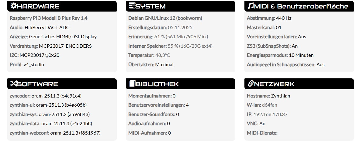

Greetings @D64FAN63 - We need more information to help you, like what kind of Zynthian youāre running (V5, V4, DIY, etc), what version of software youāre running, how you āstart the trackā, and whatās in the track, perhaps the saved sequence file, etc. A screenshot from the top level or ādashboardā of webconf will provide a lot of info, and in this case a video of what you do and the flickering result might help also. If you use the āReport Issueā button at the bottom of the dashboard it will automatically capture a lot of the info. Help us help you!

Uploading via GitHub isnāt working; an error report has been sent. The video and WBconfig screenshot are in this thread.
