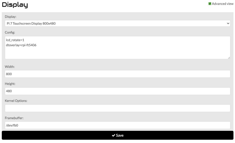

is there a terminal command to give us the exact name of that display?
It is a 7inch touch screen and I did nothing with l2C, but I see that these MCP stuff keeps popping up now. I have no idea about that. The only thing I do is selecting a display.

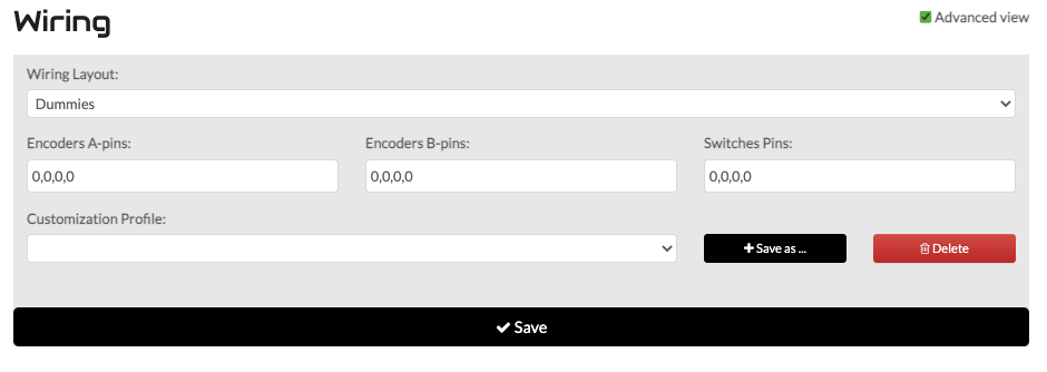

this list of MCP stuff I don’t understand. I think I have never had that previously. It showed up after the new Zynthian update.
Here are my settings:
Screenshot 2022-12-07 at 17.15.54
These are all standard settings.
I have no idea about the meaning of the l2C MCP stuff.
Kit is set to Custom… nothing else there to show.
Hardware Options are empty too.
