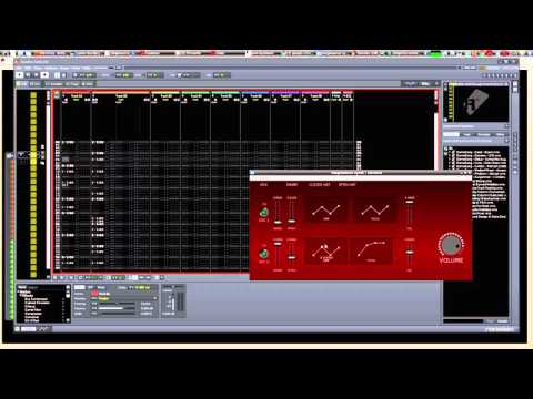

Hi @C0d3man !
I was looking for a dedicated drumsynth and I came across this one here:
Its available as a LV2. Here is the GitHub link:
Is a zynthian integration doable? It would be
to have a analog style drumsynth …
Regards!
Martin
Ok - added to recipes. Compiles and load. Havn’t tested if it make noize. Can you check this?
Regards, Holger
