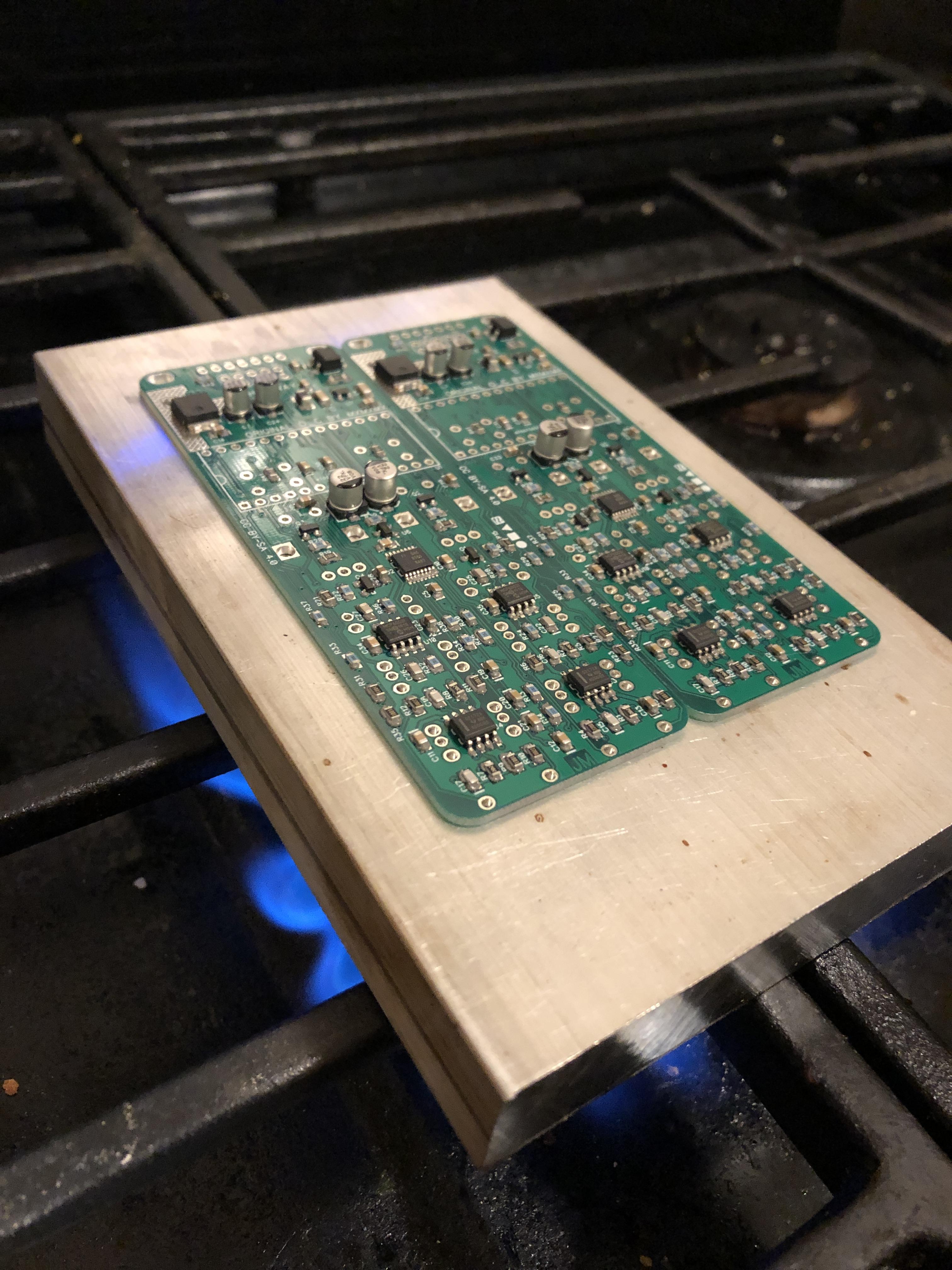

I created a soldering hotplate from some old 3d printer parts and ever since soldering/desoldering smd has become super duper simple
This we must see!
Yes, I’ve been meaning to share a guide somewhere but didn’t find the time to document it, Maybe a sneak-peek can be shared in zynth club in the next iteration

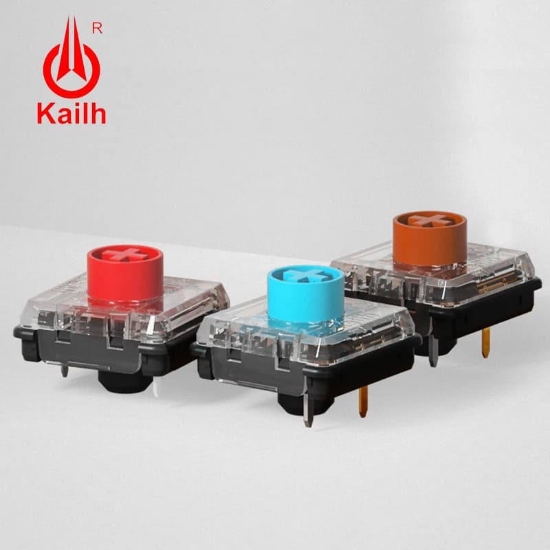

So I assume same behavior can be achieved with this kind of rgb switch

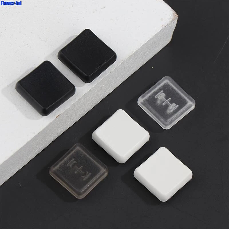

and these low profiles caps:
I can’t find nothing about this switches having a RGB led. Are you sure?
There"s a LED on footprint
same here:
But I have to say that I’m totally noob in that area
So there is an LED, but it doesn’t look like it is an RGB (read multi-color) LED.
these are presented as switches for custom (gamers) RGB keyboards
here’s another one:
Yes, that one appears to have an RCB LED that can be controlled to show various colors. The earlier one appears to have a single color LED - you can select what color when you buy it, but then you can just turn it on or off, not change the color. This is how I interpret the 2 web pages, but it is a bit hard to be sure, they are confusing.
Sometimes switches include a space for an LED, where you have to supply your own component - so that could be a single or multi-coloured LED.
With RGB keyboards the LED is usually surface mounted on the board, and the switch can be installed over the top. You just need to design the layout so that the LED aligns with a hole or light-pipe in the switch to illuminate the cap.
I made one too - it’s just a 2 inch thick aluminum bar I put on my stove! :joy:
This is exciting !
@le51
wouah !
and “this” work for soldering/desoldering ??
