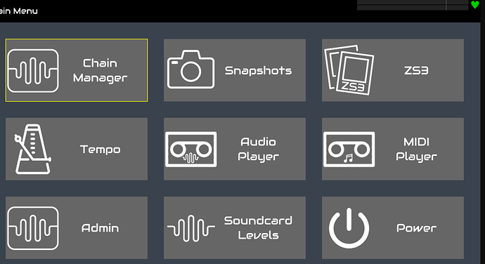

On cajon6, Vangelis crashes without even a debug whimper on selecting Chain Manager from Main Menu.
Everything else on the Menu does sensible stuff like what it’s meant to.

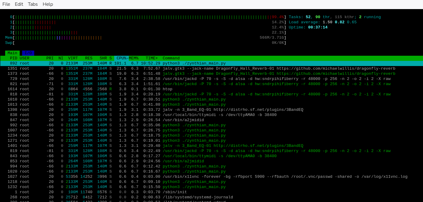

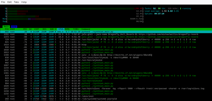

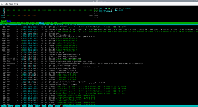

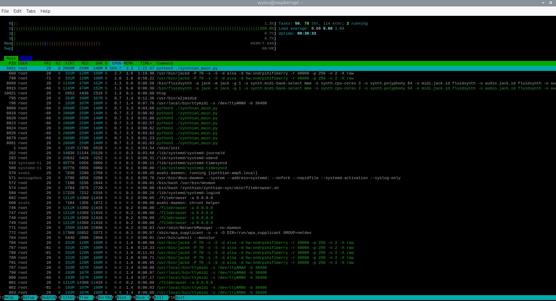

seems to spike at a whopping 101% usage of the CPU Core 0, while occupying just a mere 7% of the available memory, and has kept on doing so for more than ten minutes, thus effectively being frozen/locked.
This is indicative of a tight loop in the code. I am still trying to reproduce this.

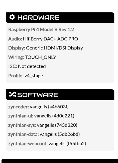

Assuming you are all experiencing the same issue (and I know we should be careful with assumptions) let’s try to find some common elements. @wyleu says this occurs with just HDMI and no touch, just VNC which would remove the touch interface from the equation. He also sees it only on a RPi4 machine. I have not seen this with a similarly configured RPi5. So can others say whether they are using RPi4 or RPi5?
Also, can others confirm whether they have 100% CPU on one core when this issue occurs? (Use top or htop in a ssh /terminal connection to see this.)
I had it happening on a V4 with Pi 4. If I see it again I’ll check the CPU.
In my case I use rpi 5, adc2 dac pro and HDMI +USB. About CPU load I cannot check It right now as I’m away from home for a couple of weeks….but in my testing I think I saw CPU overload as well.

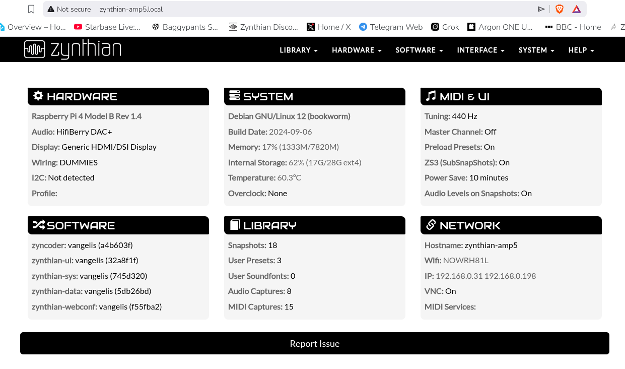

zynthian-amp5.local is now infested with Chain Manager Death, and then miraculously came back to life…!?!?!?!!???
An ancient history version of Oram.
Selected vangelis test software version
Updated.
Successfully loaded and performed 009-Zynesthesia

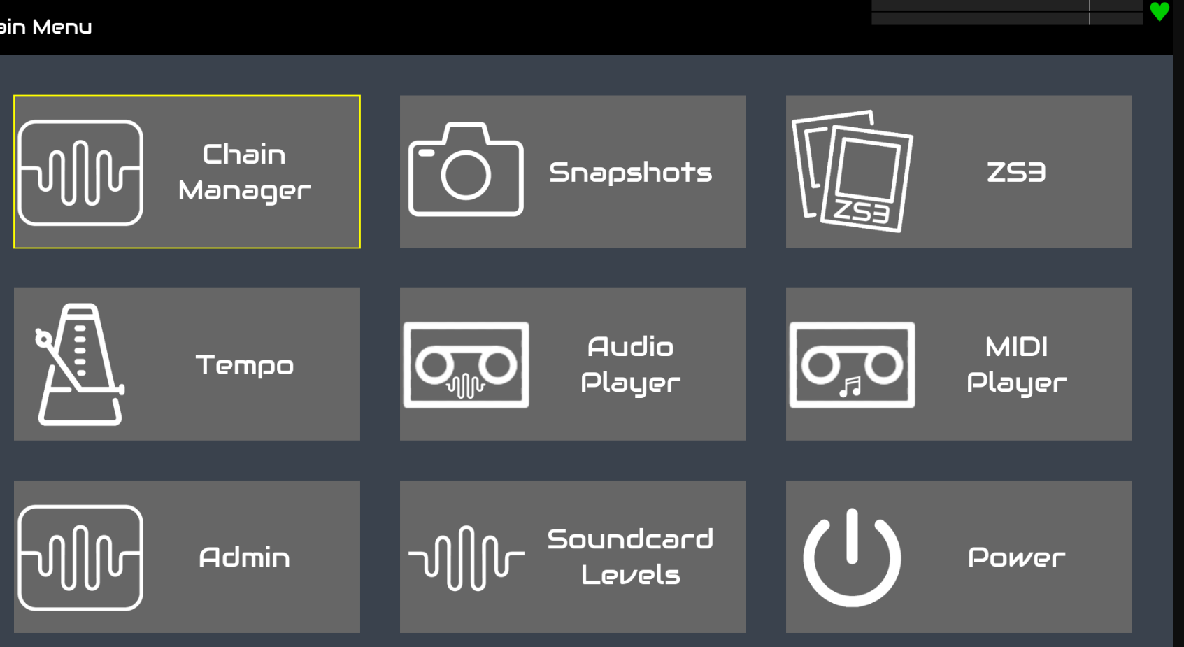

Bold press top left ( VNC & HDMI tested on two separate reboots)
To give Main Menu screen
Press ( mouse, encoder ) htop maxes out .
Here’s the context.
AND Now it’s started workking!!! on hdmi & VNC…
I can add chains and everything!!!
