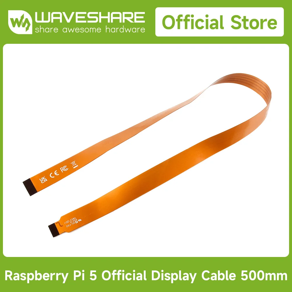

Display will work but you will need to check if it comes with rpi 5 display adaptor cable like this:
If not, you will need to buy cable separately.
Thanks @stojos I just got this one that already comes with the cable. (5-Zoll-DSI-Display für Himbeer-Pi 5 800x480 LCD-IPS kapazitiver Touchscreen mit Halter für Himbeer-Pi 4 3 4b 3b 3b - AliExpress 7)
The RPi5 has a different DSI connector to the RPi4 hence you need a different cable. The link you posted is for a screen compatible with RPi3 & RPi4. It does not mention RPi5 and the cables in the picture look the wrong type. There are displays that provide both types of cable. I bought the Waveshare 5inch which is more expensive and has some issues but mostly works. The display described by @stojos, the architect of the zynthian mini is probably the best option but does require the additional cable for the RPi5.
The cable is fairly cheap. I bought a longer one so that I can mount my screen more flexibly but the short one works well if attaching the Pi directly to the back of the screen.
