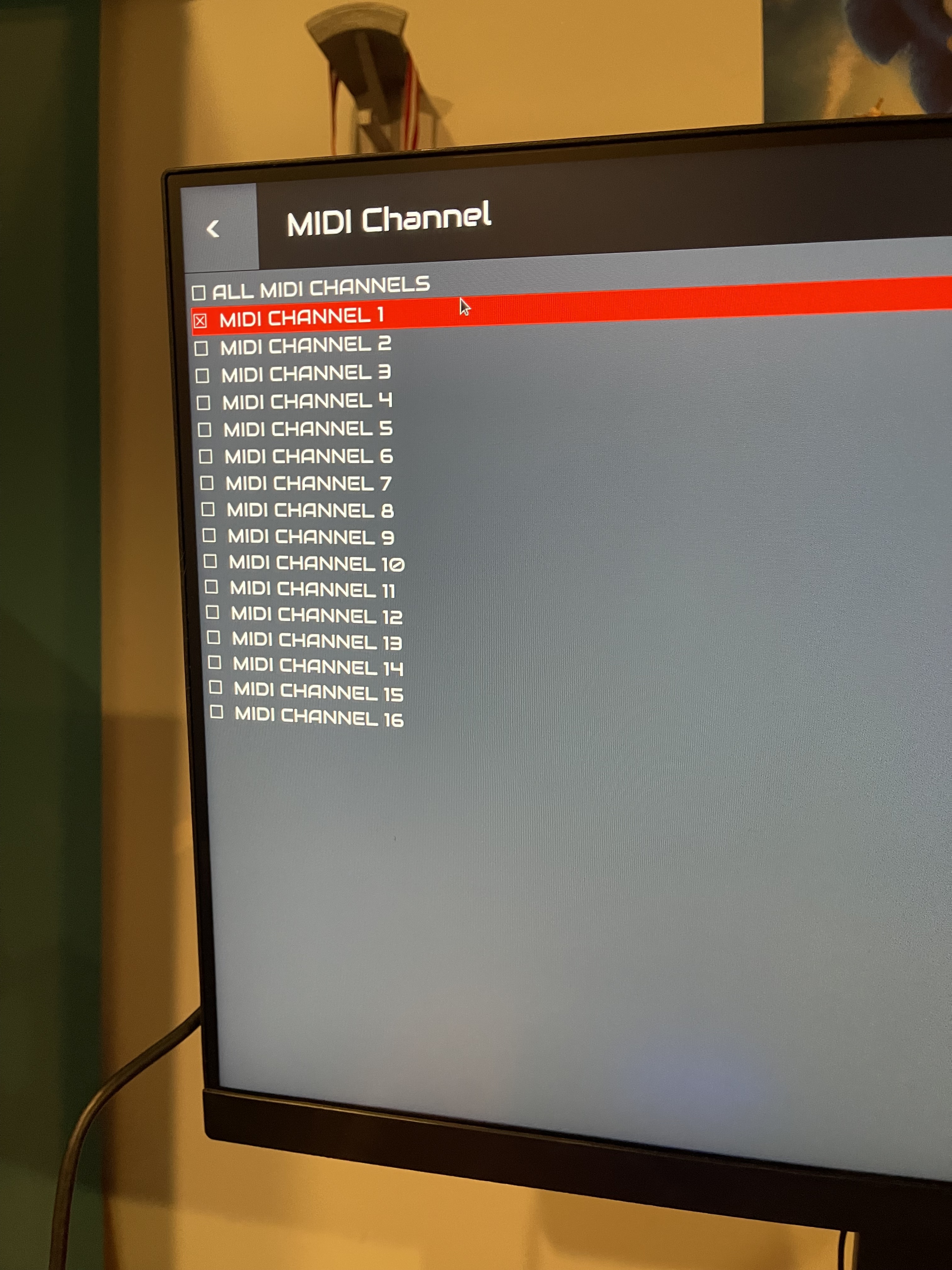

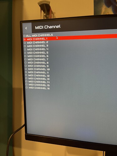

So, I tried setting up two chains, both using all midi channels. When I play, both chains sound. Then I selected my control in the Admin settings and turned on Active mode. This made no difference. Both chains still sound when I play. I thought Active mode would translate midi signals to the active chain only(?)

You should bold select the chain to access it’s chain menu then select MIDI Input where you can disable any MIDI devices you don’t want to trigger that chain.

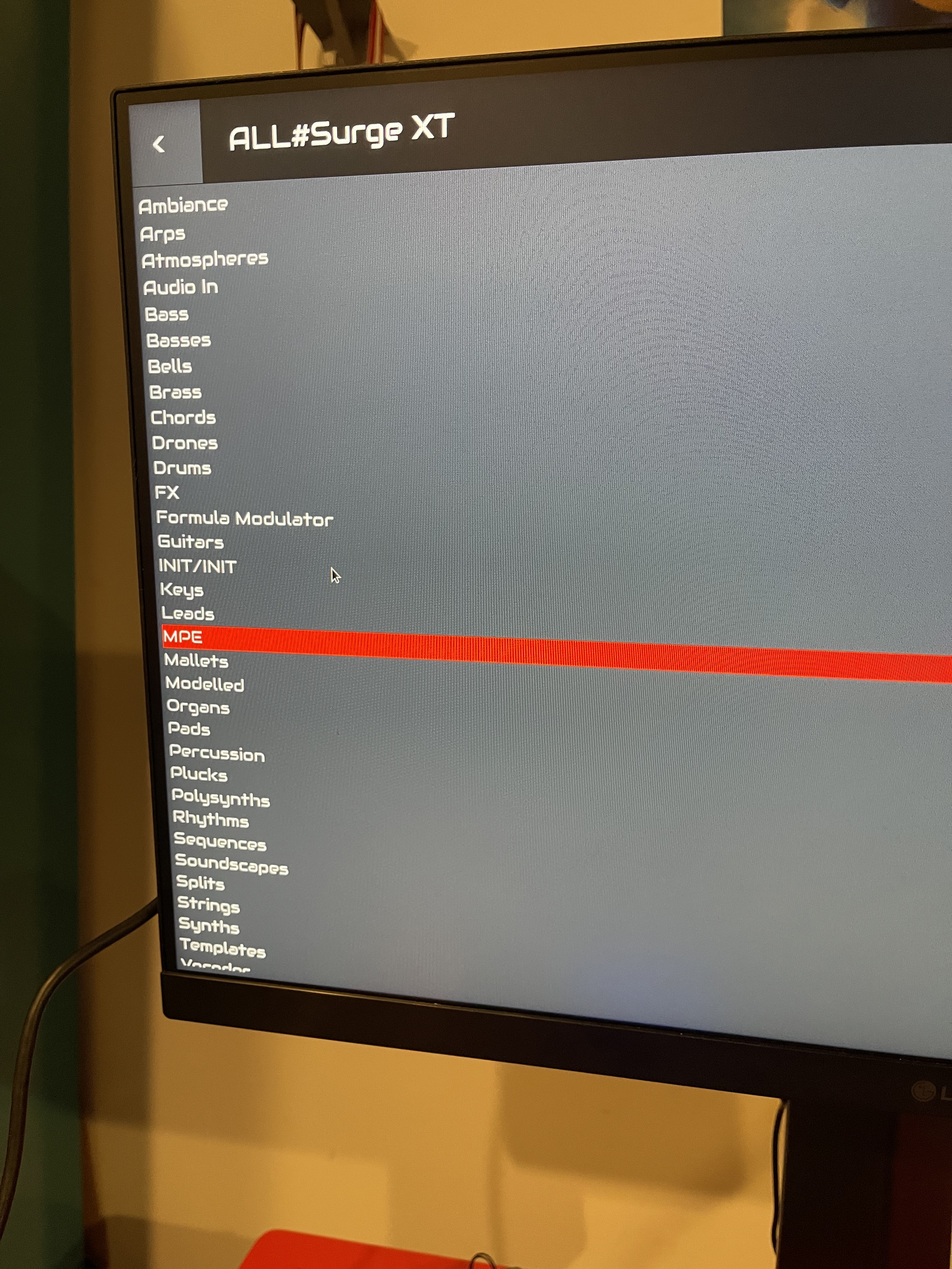

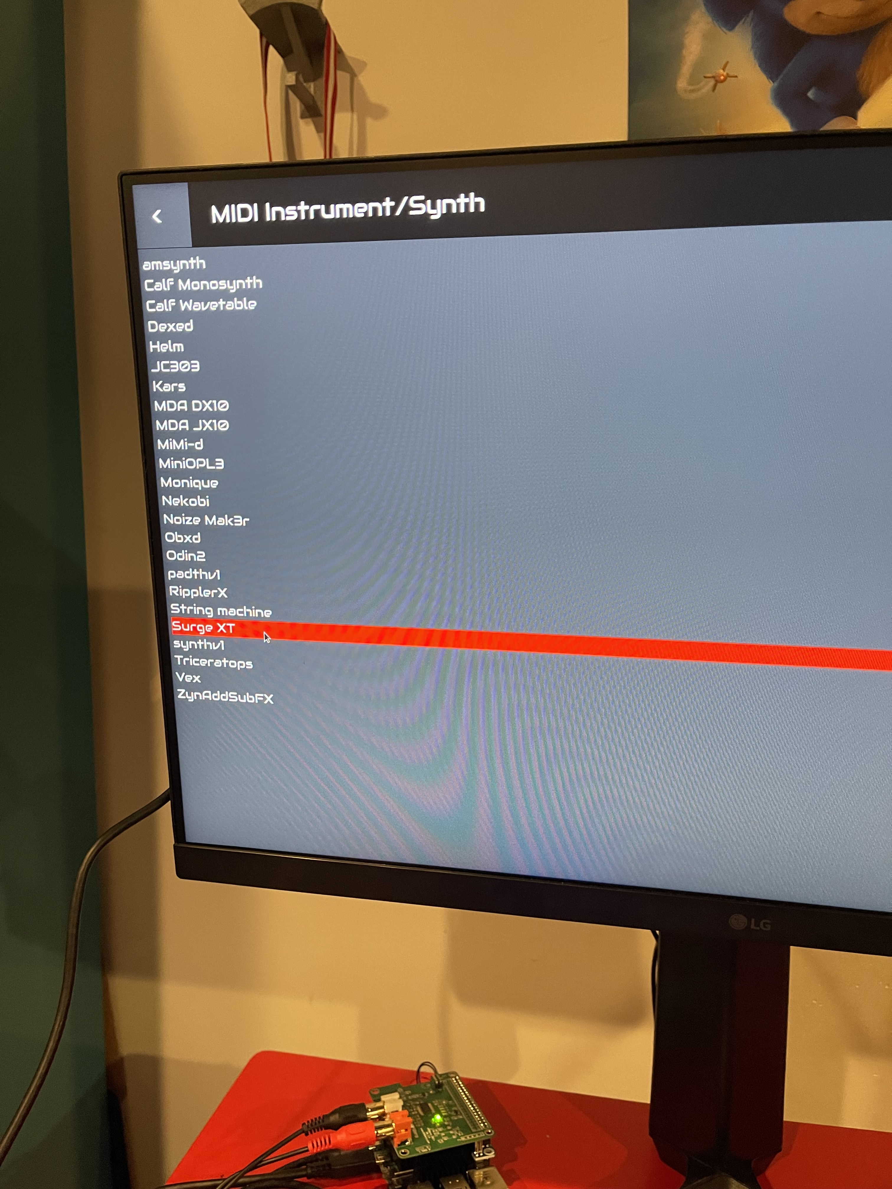

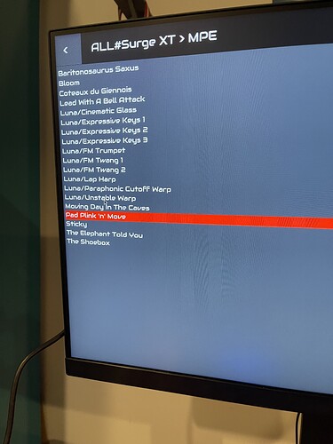

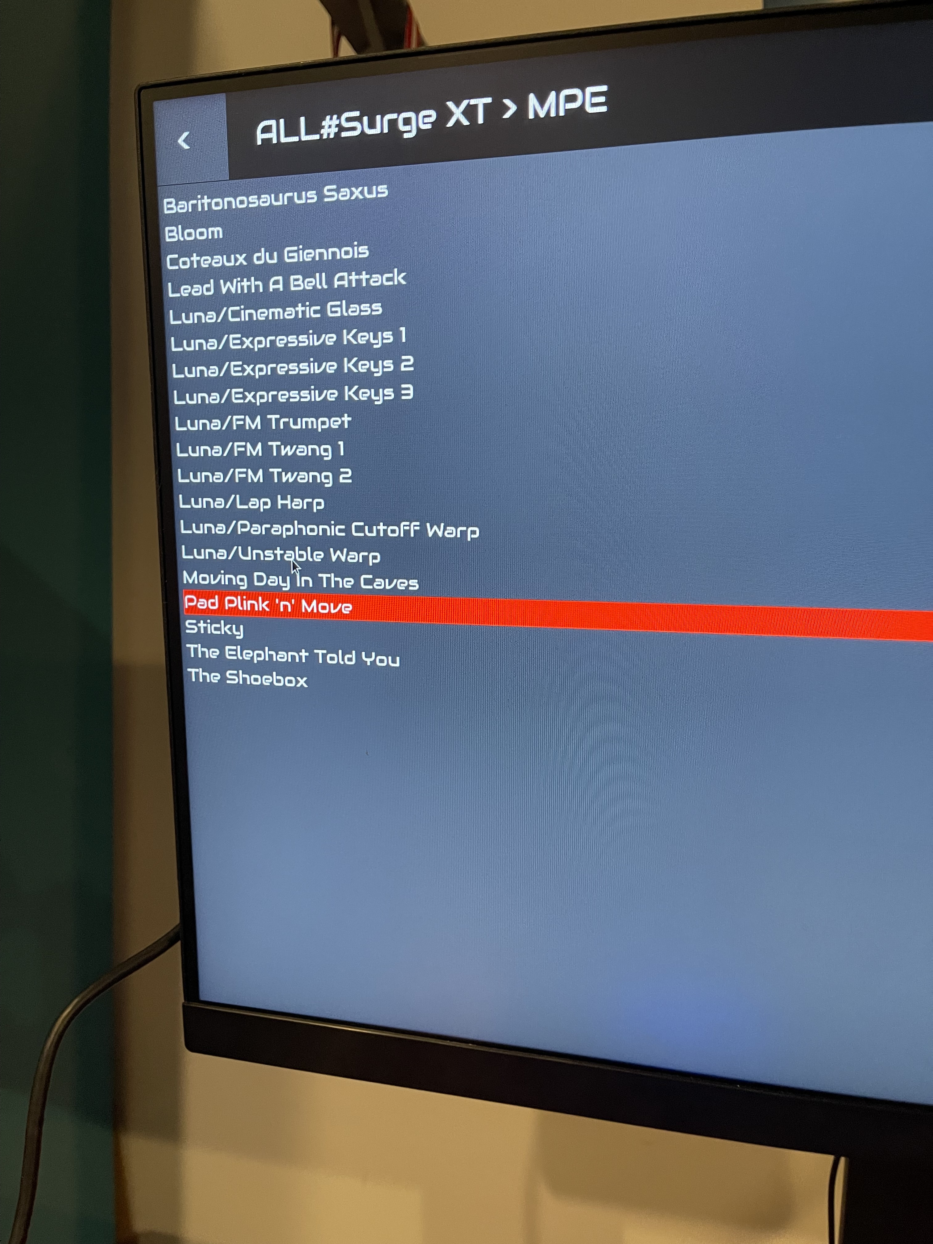

Ok so after some spelunking through zynthian interface I found the SurgeXT engine in the instrument tool chain. So I select all midi channels, then MPE and pick a voice from MPE options.
And this chain should work for the exquis midi keyboard since it supports MPE?
I just need to figure out how to configure the midi channels for the exquis keyboard.

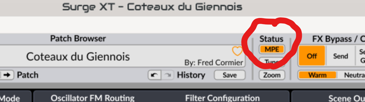

  • Click on Surge XT UI the MPE button
You can now save a snapshot (as @fussl commented), and you won’t have to do that again.

  • still from the VNC UI, after enabling MPE, click on File → Save and overwrite Surge_XT.presets.lv2

This is what I see if I click VNC engines. But it’s not the same as your screenshot to enable MPE in SurgeXT.
