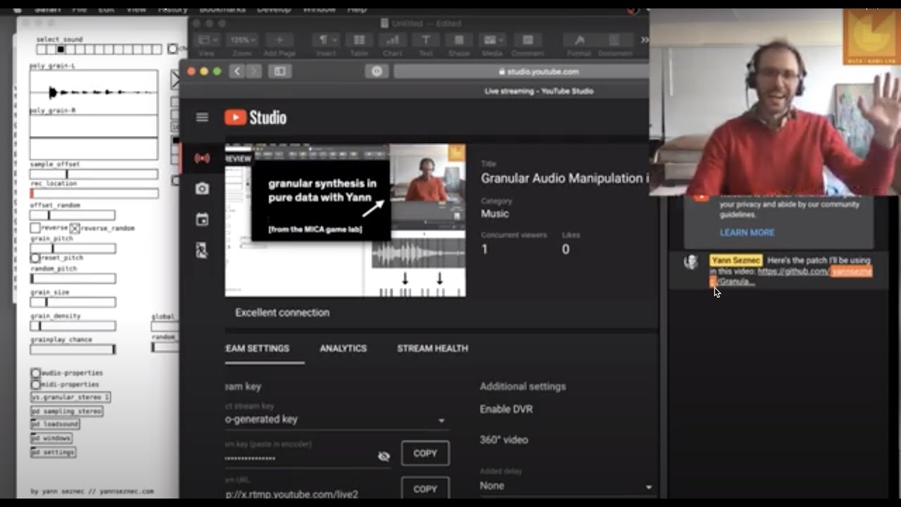

This PD script from Yann Seznec is pretty powerful…
I just tried the Granular-Sampler patch out on a RPI4 zynthian with a minilab controller. Some of the controllers do not affect the sound immediatly when changes are made, but this also happened when I tried it on my windows pc. Other than the delayed reactions, its seemed to work okay.
Nice! Gonna try it out very soon!
You did the Midi assignment directly in Zynthian setup page?
I made the midi controller assignments in the patch by adding ctlin objects to match the midi cc of each encoder. I usually run and edit the pd patch on a pc. Then I save it and create a zip file with all of the associated files and upload the zip file to the Zynthian using the webconf. One could also create a yaml file to expose the controls on the Zynthian UI and include it in the zip, but didn’t need to do that to perform the test. Further details can be found in this thread: Adding Pure Data synths ....(and Csound?)
