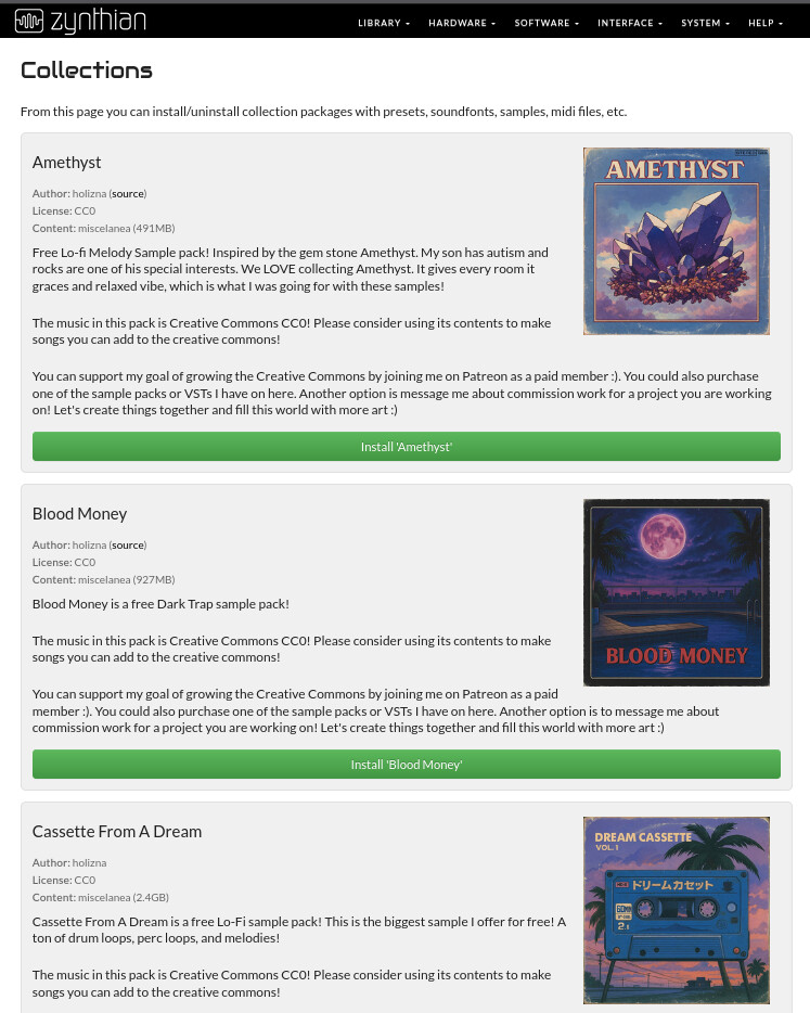

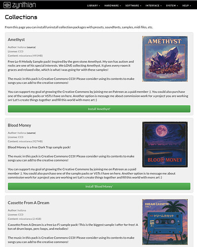

You can manage collections by accessing webconf->library->collections:
The current interface is quite basic, but it has all the needed bits. Basically it’s a list of available “collections”, with the related info and options:
  • title
  • image
  • author
  • license
  • content type
  • size
  • description
  • Install / Uninstall button
