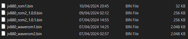

I have an additional file with something like “nvram” in its name. Perhaps your ROMs are not working or something is missing?
You need “jv880_rom2.bin” in the folder, make a copy of the rom2 files, take the first and rename it, if it doesn’t work try with the second. As @C0d3man you may want to get or dump the nvram rom bin files, useful but not necessary. Remember that you have to legally obtain the roms from your hardware!
OK, now I can finally ear the sound
