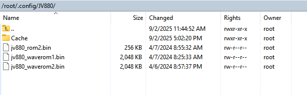

Hi,
I believe I have the .bin file in the right location (screenshot attached). I have tried versions jv880_rom2_1.0.1.bin and jv880_rom2_1.0.0.bin renamed to jv880rom2.bin. I can see and select presets in the zynthian view (e.g. 78:GamelanP2). But in VNC Engines I see “Error Cannot load ROMs…” And as expected no sound. Anything obvious I’ve forgotten?
Harry
You don’t have the jv880_rom1.bin file in that folder, it is needed for the plugin to run.
You need jv880_nvram.bin and jv880_rom1.bin to make it work.

OK - Everything working as expected now.
Those presets are probably in different ROMs…
The rom names are case sensitive. The extensions may need to be changed from “.bin” to “.BIN” or vice versa. This is assuming you have the roms themselves of course :slight_smile:
I verified: this is not true.
The issue was due to a bad upload of rom files.

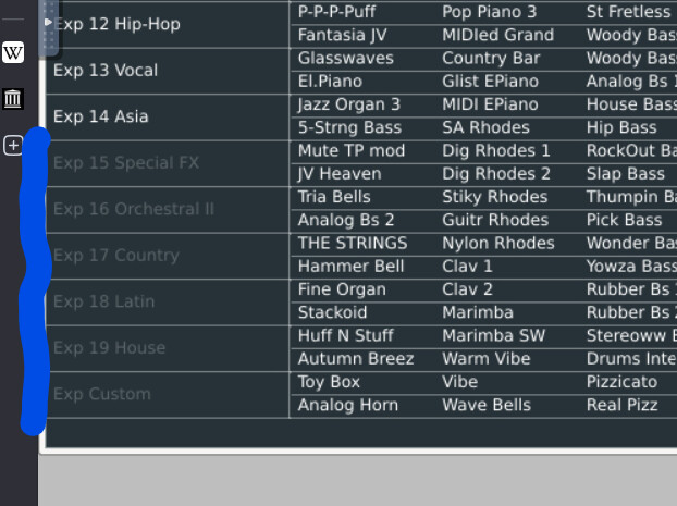

  • I can confirm that also nvram.bin needs to be added to the ROM files, for the plugin to work. Otherwise, on VNC it will claim that no ROM files are available, thus producing no sound at all.
This is the functional outcome which I can report on Oram Stable:
  • VirtualJV appears as expected, in the list of available instruments for new chains;
  • On arming a new chain with VirtualJV, presets are shown tidily ordered in categories, as per the latest plugin update;
  • Presets selected on the Zynth cannot be auditioned or played;
  • Presets can be effectively selected and played through VNC on the plugin’s interface, but only the factory library is available. All further banks and expansions are greyed-out, and contain no preset data.
Any ideas about something possibly missing or done wrong? (apart, obviously, from simply switching that specific Zynthian to Vangelis :wink: ).

EDIT: I think that I may have understood what is going on, with presets shown on the Z interface but actually unavailable from the ROMs.
Let’s see if I end up being able to effectively select all the patches from the Zynthian interface.
EDIT 2: Now I can see (and play) all expansion banks on VNC, and also select presets on the Zynthian. Nevertheless, the order of presets on the Z in Oram stable does not match the patches shown in VNC, as if there was some kind of fixed increment, that displaces the correct correspondence between name and patch number on the instrument’s GUI. Arguably, this is something that Vangelis takes care of, while regenerating presets on installation.
