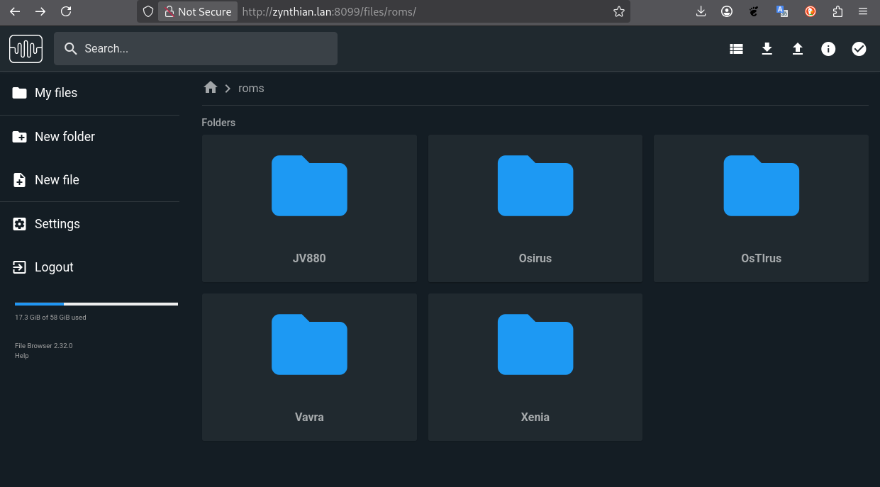

Also, i’ve created symlinks, accessible from the FileBrowser, to ROM directories for the existing emulators:
I hope this will make things a little bit easier.
Remember that default credentials for FileBrowser are:
user: zynthian
password: opensynth (or your zynthian’s password, if you changed it)

Indeed, no ROMS symlinks were shown on the Webconf File Browser.
