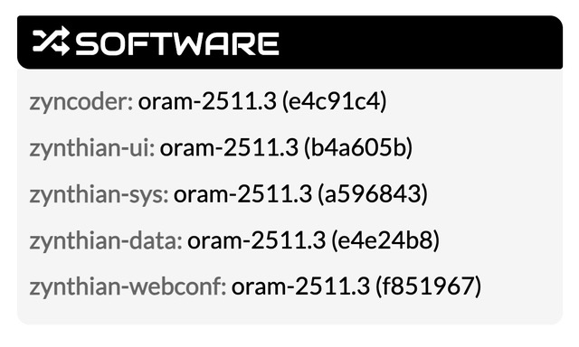

Hello @jofemodo, and everyone else possibly concerned :slightly_smiling_face:
The configuration directory for VirtualJV, where ROM files should be placed for the plugin to work, seems to have disappeared from Oram 2025-11. It used to be:
/root/.config/JV880
Also, the location of the plugin itself appears to have been moved, from the previous:
/usr/local/lib/lv2/jv880.lv2
to a new place, in:
/zynthian/zynthian-plugins/lv2/jv880.lv2
with preset data in:
/zynthian-data/lv2-custom/jv880.lv2
Copying the firmware files to both folders does not effect any unlocking of the plugin on VNC, nor of course any listing of its presets on the Zynthian GUI, even after having searched for presets in Webconf and preemptively run on an SSH console:
regenerate_lv2_presets.sh GitHub - giulioz/jv880_juce
Am I missing something?
Thanks! Best regards
Hi folks! Any clues @jofemodo and @riban, concerning the sudden disappearance of
/root/.config/JV880
in the latest Oram stable release?
I performed a deep search of the Zynthian system drive, and there seem not to be any alternative locations for uploading the VirtualJV firmware(s), except
and
that contain the plugin components and (arguably) preset data. I am on a Pi500+ hardware.
Thanks, and have a nice day :rainbow:
I will check ASAP with a fresh burned image.
Anyway, this shouldn’t be a problem. Simply create the folder and put the ROM files inside.
And please, don’t touch the plugin directory itself, OK?
