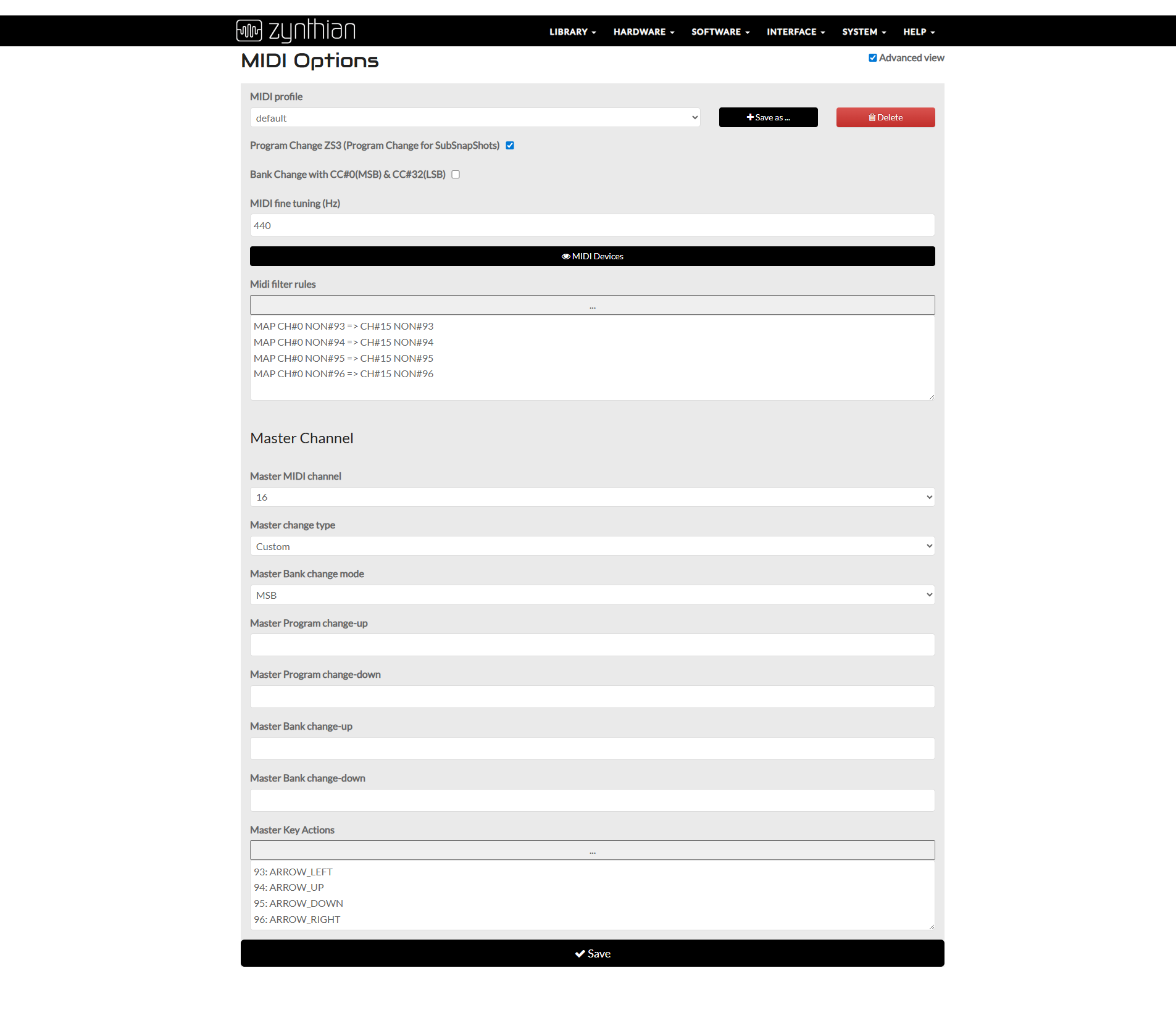

Hi, similar issue to:
Latest Zynthian (2025-11-05 22:44), Raspberry Pi 4B, KORG microkeys 61.
Mapping arrow keys working fine (see attached picture) with me:
However I’m not able to map ENTER, I’ve try:
SELECT
BACK
ENTER (chatgpt suggested)
CUIA ENTER (chatgpt suggested)
V5_ZYNPOT_SWITCH 0
V5_ZYNPOT_SWITCH 1
V5_ZYNPOT_SWITCH 2
V5_ZYNPOT_SWITCH 3
V5_ZYNPOT_SWITCH 4
V5_ZYNPOT_SWITCH 0, Push
V5_ZYNPOT_SWITCH 1, Push
V5_ZYNPOT_SWITCH 2, Push
V5_ZYNPOT_SWITCH 3, Push
V5_ZYNPOT_SWITCH 4, Push
V5_ZYNPOT_SWITCH 0, Short
V5_ZYNPOT_SWITCH 1, Short
V5_ZYNPOT_SWITCH 2, Short
V5_ZYNPOT_SWITCH 3, Short
V5_ZYNPOT_SWITCH 4, Short
V5_ZYNPOT_SWITCH 0, Bold
V5_ZYNPOT_SWITCH 1, Bold
V5_ZYNPOT_SWITCH 2, Bold
V5_ZYNPOT_SWITCH 3, Bold
V5_ZYNPOT_SWITCH 4, Bold
V5_ZYNPOT_SWITCH 0, Long
V5_ZYNPOT_SWITCH 1, Long
V5_ZYNPOT_SWITCH 2, Long
V5_ZYNPOT_SWITCH 3, Long
V5_ZYNPOT_SWITCH 4, Long
ZYNSWITCH 0
ZYNSWITCH 1
ZYNSWITCH 2
ZYNSWITCH 3
ZYNSWITCH 4
ZYNSWITCH 0, Push
ZYNSWITCH 1, Push
ZYNSWITCH 2, Push
ZYNSWITCH 3, Push
ZYNSWITCH 4, Push
ZYNSWITCH 0, Short
ZYNSWITCH 1, Short
ZYNSWITCH 2, Short
ZYNSWITCH 3, Short
ZYNSWITCH 4, Short
ZYNSWITCH 0, Bold
ZYNSWITCH 1, Bold
ZYNSWITCH 2, Bold
ZYNSWITCH 3, Bold
ZYNSWITCH 4, Bold
ZYNSWITCH 0, Long
ZYNSWITCH 1, Long
ZYNSWITCH 2, Long
ZYNSWITCH 3, Long
ZYNSWITCH 4, Long
Nothing works for me as ENTER key, some of the above works as power off, stop all sounds, snapshots,back.
Can anyone confirm what is correct WORKING(tested) CUIA action for 5.1 (latest 2025-11-05 22:44), so I may be have some issues with my Zynthian installation/hardware?
Thanks, Roman.
Hi @RomamoramenTo and welcome
I can’t test it right now but this is what I would try, it’s what I use in the Mackiecontrol configuration.
ZYNSWITCH 3
Chris
Hi Chris,
Thanks for confirming this.
As it turns out I have to map both key on and key off evens. And I only done key on events (I’d don’t rembmer where I’ve got this - some docs or chatgpt discussion states that it only accepts key on events which is obviosly wrong).
All resolved as worked as expected, thank you!
Roman
