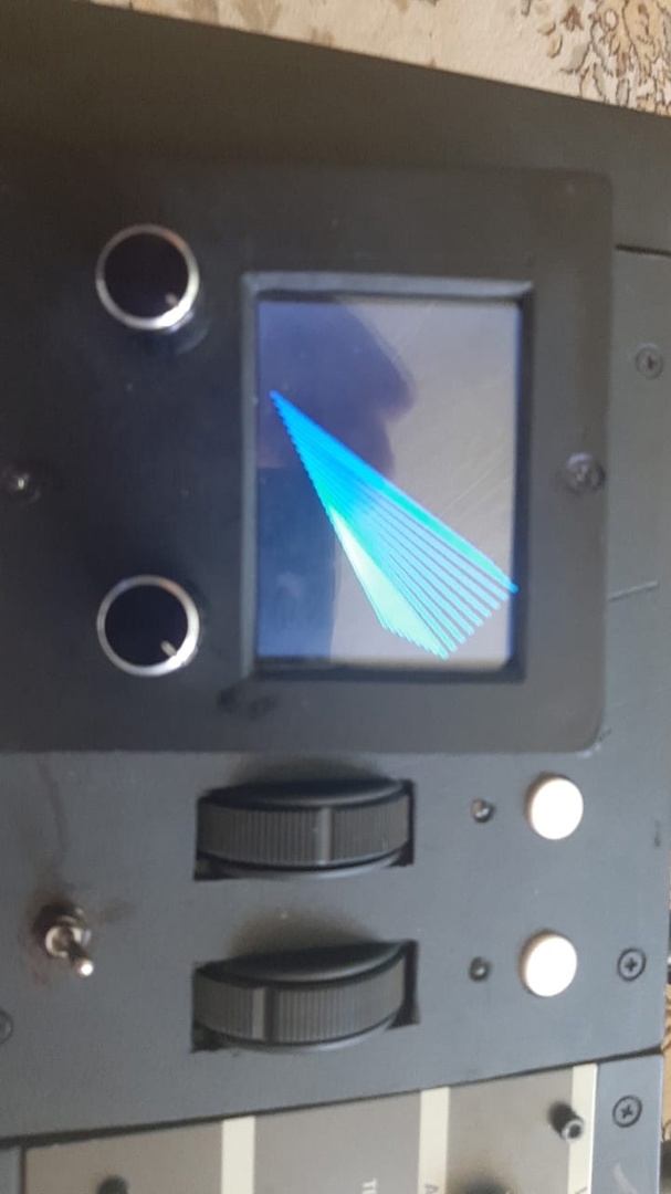

Hello, how can I remove the splash screen?

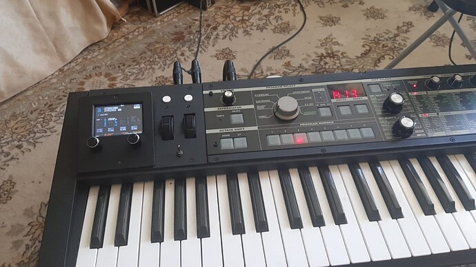

Another great diy synth made by @rozhok
How is your feeling about this custom micro Dexed ?

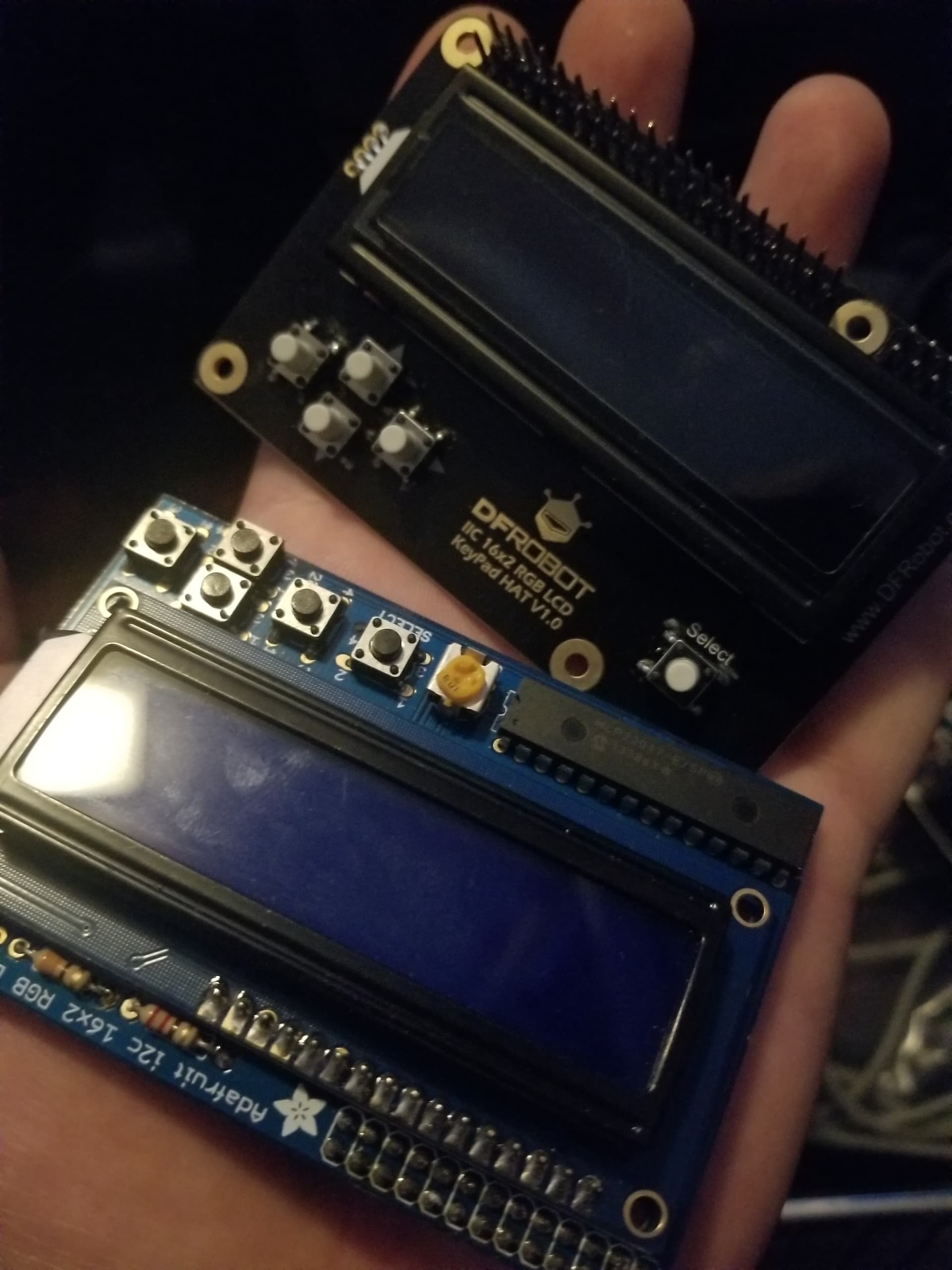

Can I use one of these screens with microdexed? I think I have a pcm dac shim somewhere and an old pi. Can I play or?
Hm, maybes yes. The display must be supported by LiquidCrystal_I2C. The DAC can be used but some features will be disabled (e.g. EQ). You have to uncomment #define I2S_AUDIO_ONLY (and comment #define TEENSY_AUDIO_BOARD) in config.h. But I havn’t tested this code last time some years ago…

Hi Rozhok, the splash screen is gone since a few weeks, just download lastest code.
Could work with the older text-driven version of [C0d3man] but you will be missing a lot of new stuff that uses the TFT+touch (ah and both is based on teensy… there is a group working on the Pi, https://github.com/probonopd/MiniDexed but with different goals in mind)
