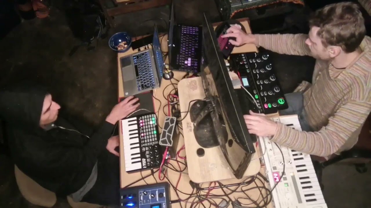

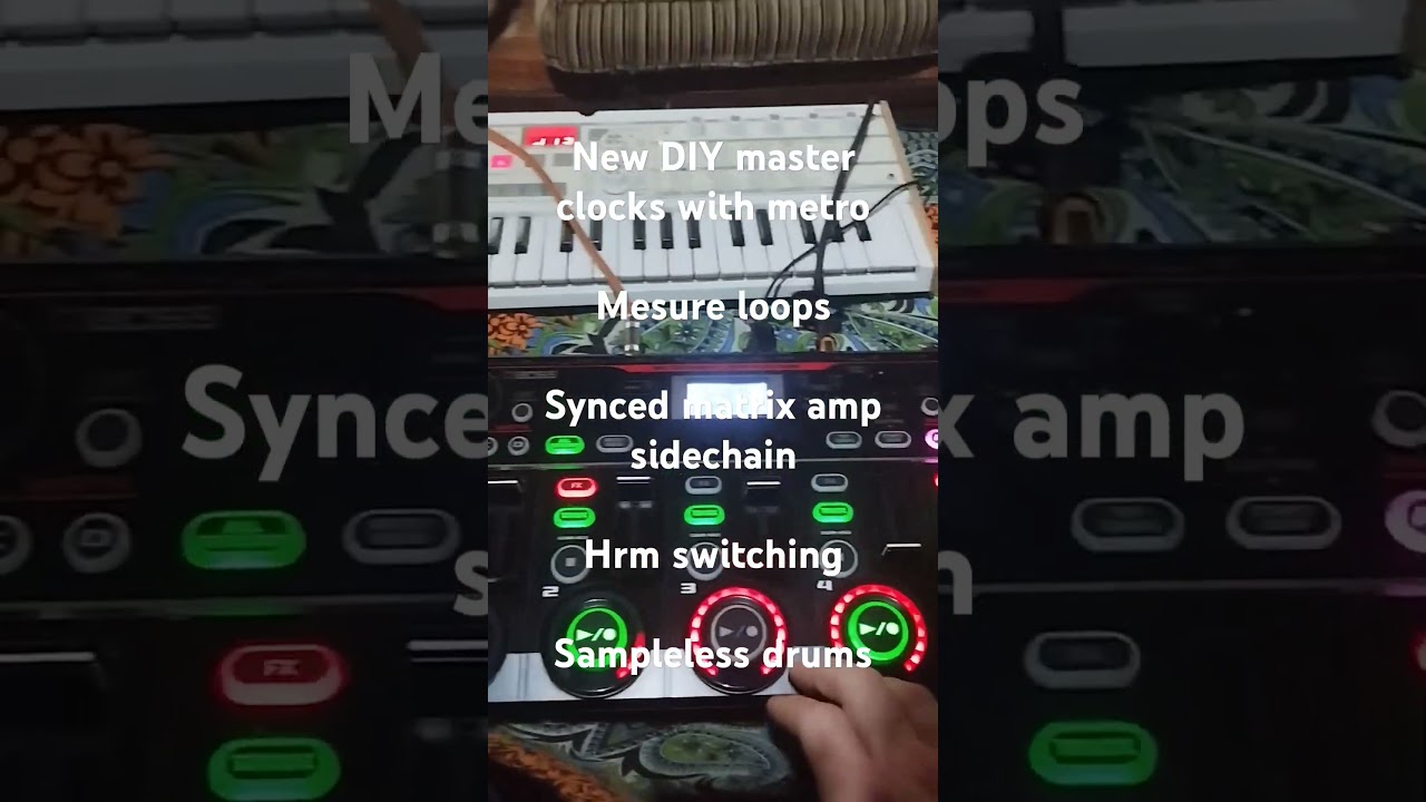

this was this weekend, mininova/RC505 mk2 (with ableton over my own live link to hardware midi bridge)
microkorg/RC505 mk2
here the guy standing is using my custom carla setup with sooperlooper, the midi controller lights work in the daylight, a screen would never work there
Dual custom loopers on Ableton, Mininova, Microkorg and the RC 505 mk2 together
