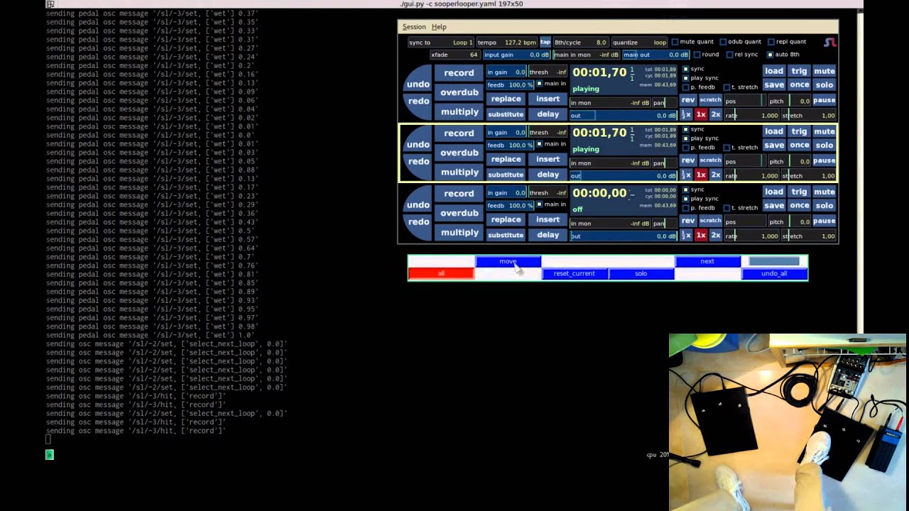

I tried both (SooperLooper and Loop192) on PatchBox OS.
The Loop192 has not implement save of midi loops.
I had setup with Behringer FCB1010, which sending midi notes. This was converted to OSC by mididings. But dancing over pedal is not very confort for me. I have more linear filing of music flow. So my idea is have midi file, which will be record/play/stop loops in SooperLooper and Loop192 and also wil be play drums on backgroud. This is simplified idea based on Zen Audi ALK2 (this project was closed)
Framework from midi file will be driving loopers by converting midi notes to OSC comands. But it is long way …
