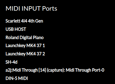

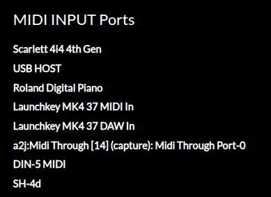

I do need some help to just get the controller to driver to show up in zynthian. I’ve tried all sorts of combinations on the names that go under dev_ids. I even tried to put an “*” to force it to show up like the fostex controller driver.
This is what I see in webconf when I first boot up zynthian:
If I unplug and replug the mk4, the name changes!
aconnect -l will show the same info as above.
