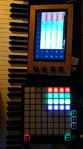

Sure try it out and let me know how it goes. I haven’t figured out how to map the knobs to the encoders on the mixer screen, but I did manage to give functionality to all the other buttons. Check my notes on github.
I’m working on a driver for my Launchkey Mini 37, everything is working how I want except I’ve ran into a midi limitation. I have 4 knobs set to the zynpots and that works but in menus with over 127 items (Vitalium for example) it gets stuck when it hits 127. Is there a proper way to implement this?
Here’s what I have so far, it’s more focused on performance. First bank(up arrow) of knobs are mixer controls, second bank(down arrow) are zynpots on the left, top row of pads are solos for mixer, bottom row are mutes, up arrow in the pad area is presets, down arrow is menu, right arrow is back, Func is Select. Everything works but the pads don’t update in realtime, I put a delay on startup for 10 seconds to make sure chains are loaded first, that’s mainly what I’m focusing on at the moment. There’s some code in that I need to clean out from failed attempts to do this. There’s also the issue from my last post of the zynpots not being built for midi. It’s still a little buggy but functional.
You should condifigure the Launchkey to use incremental encoders, not aboslute then use nudge up/down CUAI calls.
I tried that before trying wrapping(which was a fail too) but I think my implementation was off in some way. I’m very much still learning. I’ll revisit it and double check the programming guide for the launchkey. Thanks.
Pads update with the mixer in real time and knobs are fixed, buttons are also remapped to better positions(Func is Menu, > is Sel, up on the pad arrows is Back, down is Preset) . I’m 100% happy with this now. It’s complete for me and hopefully others. Thank you.

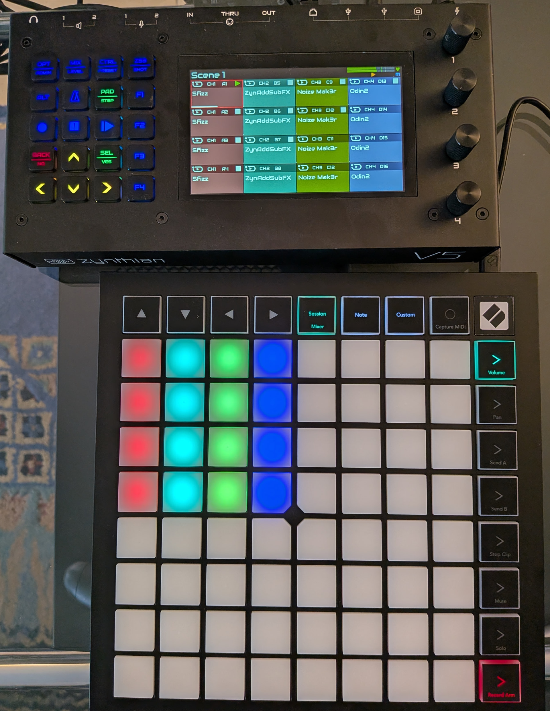

Sorry, does anybody have a Launchpad X at hand an can confirm it provides the same or another functionality in session mode than mine?
Actually clip launching completely works for me, but the pads are not lit at all. I think this behaviour changed.
I’m on latest Oram staging and the LPX firmware was updated with the 2.01 release I remember.
I tried a Launchpad X a few months ago and didn’t get the pads lit with the color of the sequencer at all. Everything remained dark. But again that was a previous Oram release and i can’t currently retry it.
On the same day we tested a APC Key 25 and that worked perfect with the pad colors and functions.
Sorry that i can’t retry right now, I just replied because the Launchpad X driver didn’t work months ago and it’s maybe not a new bug.
Thanks, I’m sure it worked last time (long time ago), but I rareky connected it to the Zynth and I have been late to the firmware update party, so I wonder if the ctrldev just works with a specific software version of the Launchpad X.

So, like stated above I can confirm that Launchpad X works as intended when applying these changes to the Launchpad Mini MK3 driver.
I just don’t have the courage to do the PR because I don’t read python fluently and cannot confirm if this would omit functions @Wapata included in the old (non functional) driver.
Here’s what I tested and is working with these changes:
  • Session Mode accessable
  • Arrow Keys
  • Stop all
  • Reflection of Zynpad, including flashing feedback for start, stop, running pattern
Here’s what I guess is working but cannot confirm yet:
  • Scene change
So if anybody can compare these, go ahead :wink:
I’ve tried this change with a Launchpad X and it seems to work:
I did now, see Update Launchpad X ctrldev by johannesmenzel · Pull Request #551 · zynthian/zynthian-ui · GitHub
