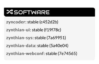

Hi, I have a quick question, The repository screen in webconf states that I use the ā€œstableā€ repository, but I don’t see any update ?
Should i switch to the ā€œoramā€ repository to be able to update ? is it safe to do that or should I erase my SD Card and re-install ?
If you are on the Oram release, stable release then you should get updates to the stable release when they are released. If there is not update availble indication in the UI then you are likely to be on the current latest stable. What does your webconf dashboard show for each repo?
I am all Ā« stable Ā»
That is wrong. What image did you start from?
I had my kit in April 24, I used the stable image at this time, should I change ?
Yes. The old stable version is no longer supported. You cannot update to the new version through software update. You need to flash a new image.
ok it makes sense. I made a backup, do you think the backup will work with tne new version ?
