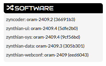

Hi @riban,
In answer to your earlier post, I’m kind of on 2409.4, but webconf is still frozen on an earlier version. I’ve not been able to set the repositories in webconf as I just get an internal server error when viewing the page - can this be set via cli at all?
Current software versions below -
Update logs show i’m still having issues reading a file in webconf/.git/objects/
getting a fatal :unresolved deltas left after unpacking
I suspect due to the issues I’m having I may have a corrupted install, which may have been present before the original updates.
Reflashing won’t be an issue, but happy to continue troubleshooting on current install if it’s of any help to pinning down other problems.
Its taken me a week to run the update because I only have 1GiB ram and it kept crapping out trying to compile setBFree with the zynthian-webconf service running. Please for the love of God, if anyone knows how to build debian packages and host a repo, can you give us a hand?
Please reimage. I think the fixes that are in vangelis will resolve many of these git issues so a future update should be less painful.
