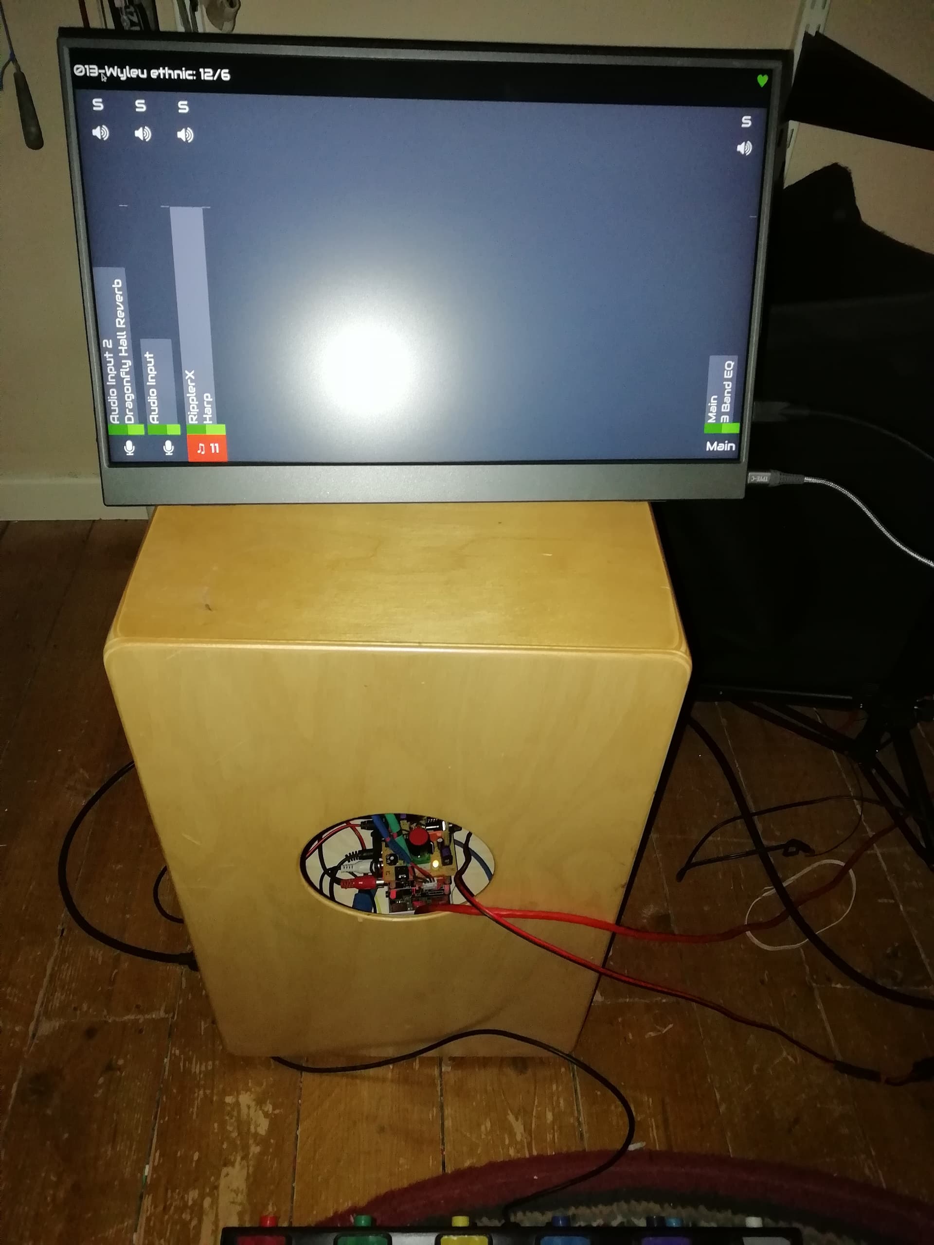

Here’s Rippler, zynseq and an cajon . . .
Now that’s clever…
Several people are getting less soup for all this…
I read this several times and still wondering what is this magical cajon? I only read it has electrical power supplied so it is not just a wooden box.
A cajon with a zynth, a hifiberry adc dac card and the piggyback amp, driving audio excites on the cajon side, with a electret ( not condenser) microphone inside… Resonance guaranteed!
Wow, that is cool. How you supply the phantom power to the condenser?
It’s an option jumper on the hifiberry card.
All powered by a 20Volt drill battery. It does drumming circles.
I have to look into this. My Dac2 Adc Pro has does support and has jumpers for “Mic bias voltage for the use with electret microphones”, but I thought this isn’t the same as 48V phantom power for my Rode mics. I didn’t find anything in the internet about that.
No this is simply one of the little low voltage electret capsule mic’s. It’s phantom powered in the sense that a few volts are applied to the microphone element but it’s not 48v phantom power.
Can’t find mention of it on the ADC cards data sheet but it’s definitely a feature cos it works.

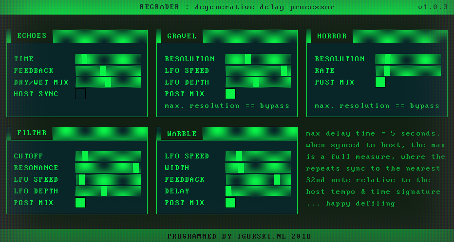

BTW, i changed your group names/titles and took the group titles from the native GUI:
I wanted to keep in the zynthian UI some of the special “GUI character” of this little jewel:
I like this “monochrome green phosphoric look”. Somebody wanting to design a similar color scheme for the zynthian UI ? :nerd_face: @Aethermind, you custom color scheme also use green & black colors, right?
Please, @hannesmenzel, keep generating custom TTLs files. It’s a HUGE contribution to the project!

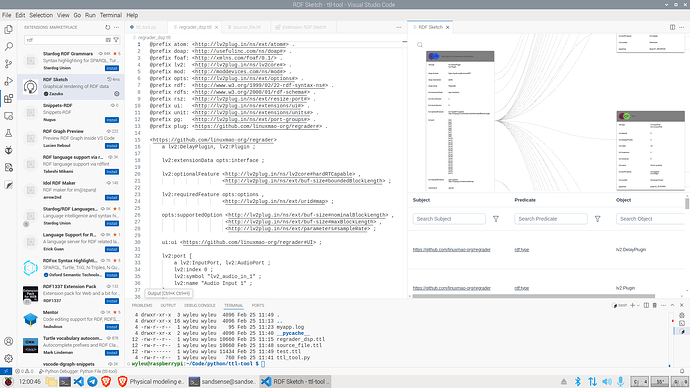

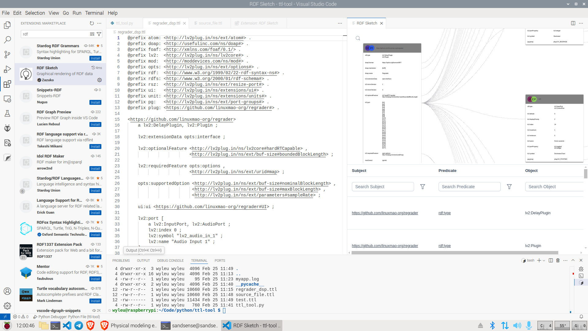

Visual Studio Code includes various extensions for visualizing tll files, albeit as RDF files… . .
Now that looks cool, I’ll see if I can find some benefit for me.
There should be some good tools out there that deal with the drudgery of spooling thro’u text files which become unwieldy on length.
Just seeing how the structural graph grows as structure is imposed.
We want to zynthize a base structure into the flow from external ttl to zyn blessed citizen file.
Even if it’s just a script to apply to any incoming tll file to add some base categories in line with our expectations.
Mechanizing now saves an awful lot of enthusiastic syntax events in hand edited files.
