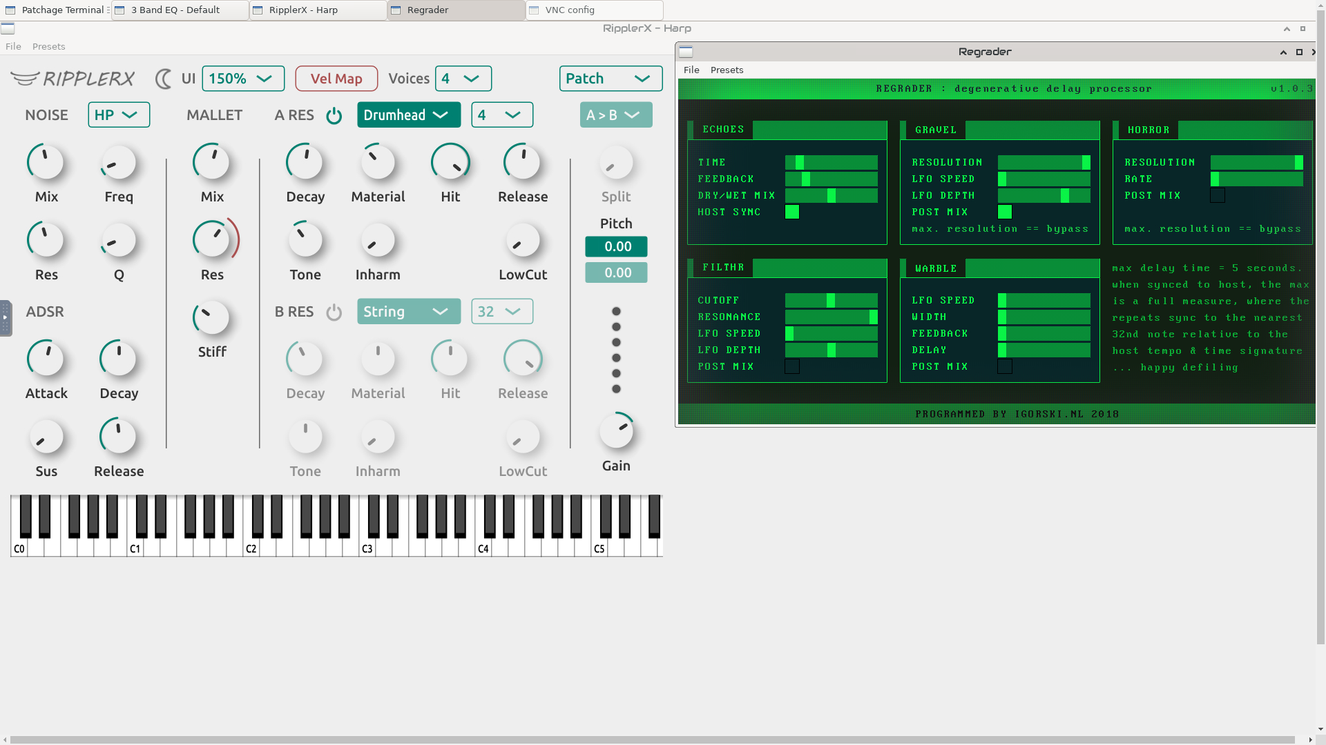

Hi @jofemodo! :smiley:. My custom colour profile is based on a spectrum of blue-light blue-greyish cyan and green (basically, my fav colour areas), but it would absolutely suit me to design a green monochrome scheme a-la-Fairlight for the Zynth! :ringer_planet:
This would be fantastic! Please, do it (not in a hurry, of course!)
Thanks
:+1: :slight_smile:
