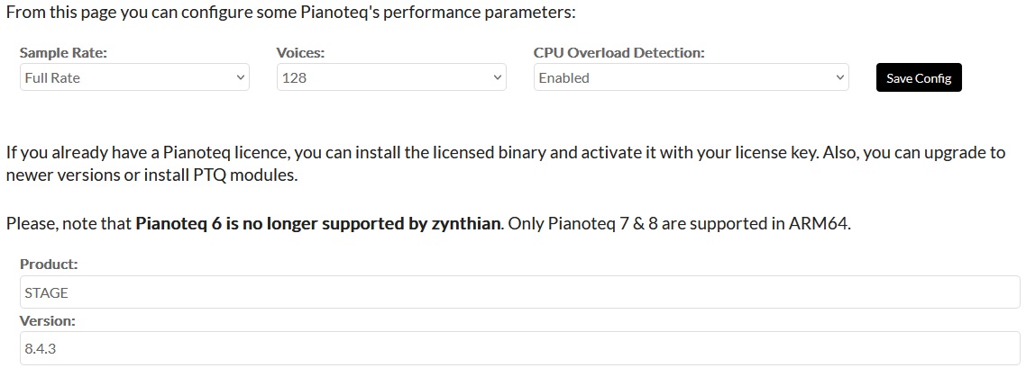

Modartt have changed the compression of the linux package and webconf doesn’t recognise it. We will need to change webconf to accept tar.xy.
Pianoteq 9 may now be installed in zynthian Vangelis. @jofemodo please check it is okay then I suggest merging this fix to Oram Staging.

Can you tell if it replaced version 8 or did it install it additionally?
Replaced. You download the new version and you install it with webconf overwriting the old one.
I have just pushed a fix to Vangelis. Please update and retest.
