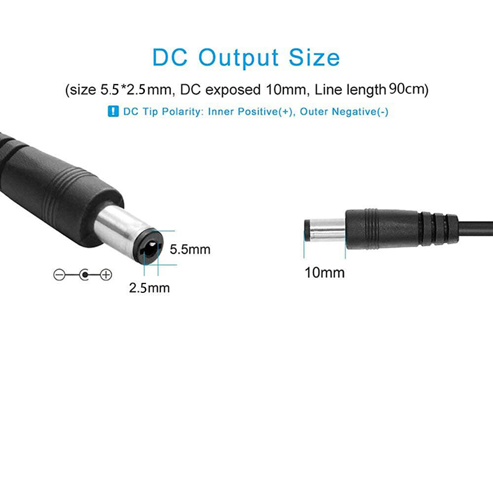

Extra tip:
The connector that is common in my part of the world (5.5x2.1mm) does not fit.
These are the verified dimensions of the mating plug to the Zynthian V5 and V5.1 power inlet:
Search terms - Barrel Connector power supply pedal

Hi all, I’m looking for a 2nd power supply (I’m in the USA), this one looks correct to me. Does anyone see an issue before I order it?
I think that has the wrong size barrel plug - these are the dimensions-polarity for V5-V5.1 for the right one:
and here’s one that looks good:
The link defaults to a 2 pack, but you can select 5A which gets you a single supply.
I took most of the above from this thread:
This one came in the mail already and I can confirm it works! ![]()
