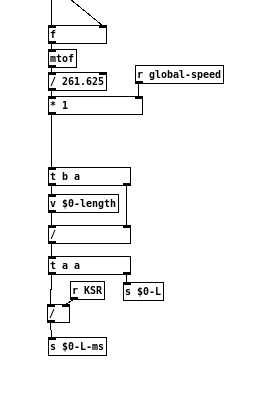

OK! I’ve included the fixes proposed by @gitnob.
For fixing the sample rate problem, i added this block to the DACADC subpatch:
So now we have 2 global variables SR and KSR that can be used for replacing the hardcoded 44100 or 44.1 constants where we found them.
For instance, i fixed the “samplervoice.pd” in “Basic Sample” patch. Like this:
I fear we need to do the same across all patches and submodules ;-(
