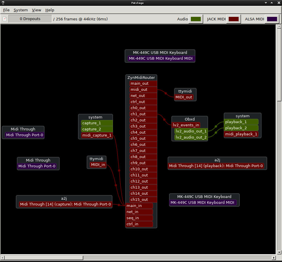

Looks a lot easier to present if we filter out the uninvolved functionality.
Could we provide a background image or colouring and ordering that put the inâs and outs in first or last column? . I find patchage much easier to read but frequently graphically unstable , but that really makes for a much easier presentation.
Iâve suggested this purely as an alternative to using QJackCtl or patchage, not as something we can stuff into the zynthian-ui. It has another non-grid display mode as well.
