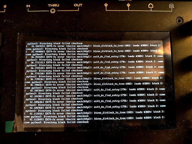

^ Until I ran an update which booted to an angry Daphne.
Since I respect her authority, I promptly removed the card and burned it with the latest ORAM img.
Again, it booted fine. until I made an update which again summoned the angry Daphne.
I can repeat this process ad nauseam.

Now, this is my goal today to finish this RPI{4,5} migration which started 4 days ago. Whay do you know : this morning, after letting the Zynthian alone for a day, it boots and reboots just fine… what gives…
In the “error” boot screen, the webconfig is not available, only SSH. But now, since everything works, the webconfig and audio setup is as expected.
Uploaded the pianoteq binary → reboot → error boot screen → reboot → error…
…why ? So random.
I’m logged in through SSH…
Tried :
→ systemctl status
Rebooted for the n-th time (doing absolutely nothing) and now : It works!
:sob: why…

Anyway, you didn’t give us the needed details, nor logs, so it’s difficult to help you with such a limited info. Please, attach:
  • Picture of the ERROR screen, or at less, tell us what it says
  • Snapshot from your webconf dashboard
  • logs from UI
