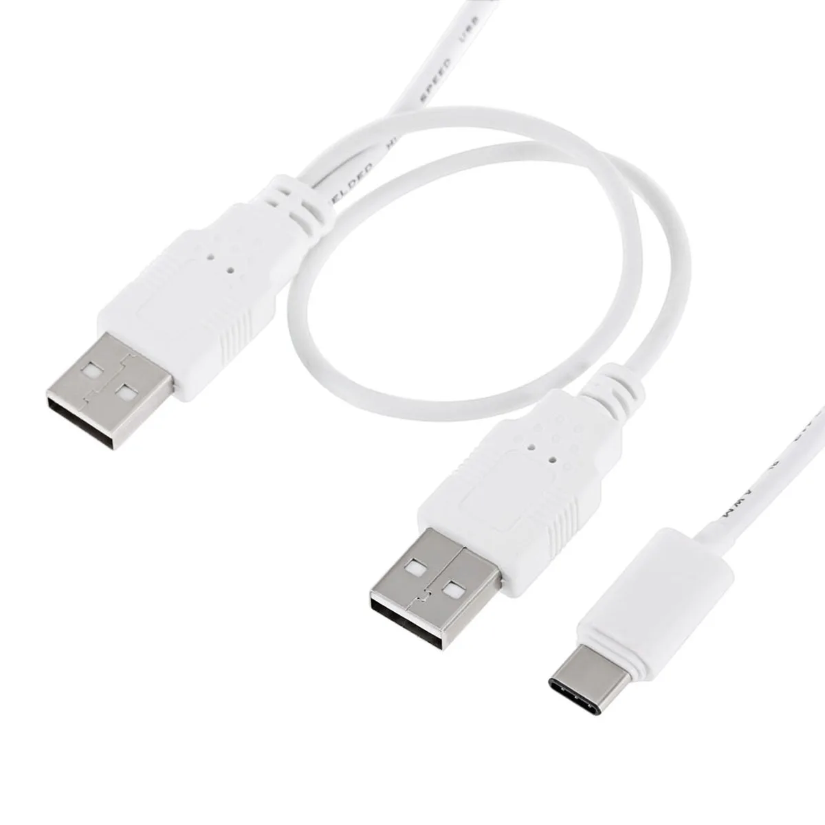

What we need is a custom cable that separates the power from the usb 2.0 data lines
none can be found premade unfortunately.

I think that cable might be the wrong combination. It looks like the data + power is fed to the type A with power derived from the other type A and just data feeding the type C. We need power + data on the type C.

I also think that maybe we would need an Y cable with a derived USB-C data+power extension, in order for the OTG USB-Midi connection to work.

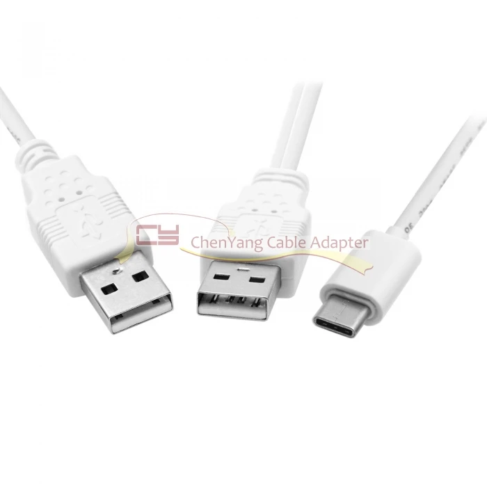

This is exactly what this cable does. It have 2 x A connectors, but only one is usable for data. The other one is for power only. If you look at the photo carefully, you can see what i mean:
BTW, i bought a pair for testing …
Regards,
It was this picture that made me doubt the power feed to the type C connector:
