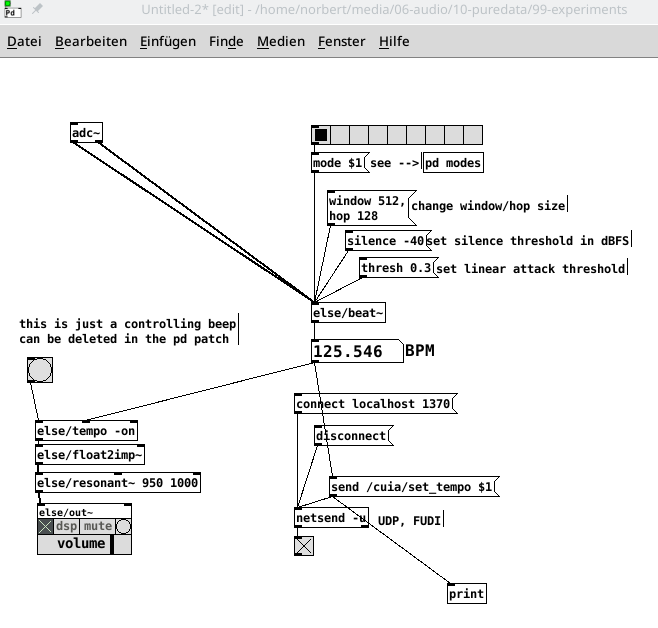

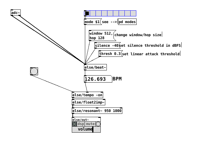

I already wrote a small python script that can BPM detect tracks, which I use to label my vinyl records.
We could add an audio to BPM module but it would require a feature twist and preferably some developer effort. Maybe what you have already done may form a starter.
I just opened the AI generated file from the confident AI to see what it does. I stopped looking at it when I saw that messages are connected wrong. Well, as you said, they are always confident, until you say “no, this is not correct”, and you’ll get another more confident answer :wink:
It’ll be better to use “classic” internet search for beat detection with puredata. Or just beat detection.
Like that one in the else library of pd. With different detection algorithms and lookup window sizes, and …
I could just make a puredata patch and send some BPM data via OSC to Zynthian’s CUIA for example. This could synchronize an audio input to the BPM of Zynthian’s internal metronome. I don’t get information about the beat or bar starts, but it could be helpful in @lord-carlos case.
But… as any detection it’s not 100% correct.
The Union Audio LE page says “and a BPM delay with automatic BPM detection that will allow timing to be overridden by a tap tempo button”. Hence both, and IMO it’s necessary because automatic detection could be unprecise or wrong. In your case it would perhaps helpful to use a foot switch for your BPM TAP button, to have both hands free and setting the BPM by foot?
@riban: Wouldn’t it just be better to have a beat detection option within the metronome code?
I’ll give it a try this weekend…
Hence Zynthian could be used as a free programmable DJ-tool, with BPM detection for effects….
Regards ….
O no, it could be so easy, but I forgot that Zynthian is still on puredata version 0.53.1. The else library is not good enough for this. Would be nice to have the puredata version from the bookworm backport… 0.55.1 at least.
I’m going to try to install this backport version then without destroying my whole Zynthian system.
Question: Would it be an option to install the backport version for puredata in general on the distribution of Zynthian instead of the old bookworm version? Or does it make things too messy.
The trigger word is, “just”. Anything is possible, but nothing is easy! It would be good to have a beat detection module in zynthian as core functionality but someone has to write it. I haven’t had time to look. There may even be one written already, e.g. LV2 plugin???
Zynthian Will follow a MIDI clock or a slower GPI timing pulse, extrapolating to attempt a stray beat. If a software module can detect beats in audio, it could be merged into the zynthian tempo control.
@riban, okay.
What do you mean by module? I could try to write a zynthian engine in python, because there is a python module called aubio for audio analysis, which is exactly the base of puredata’s else/beat~ abstraction. Then it would be a special engine.
Or directly in the timer GUI. I’m not sure where exactly in the python codes of zynthian to implement a “core functionality” for the BPM detection. Would it be the best in zynthian_gui_tempo.py ?
If you could give me a hint, I’d give it a try.
Github is our friend. We need something super efficient (c or c++) we can integrate at low level in the Jack loop.
or as I said GitHub - aubio/aubio: a library for audio and music analysis
python library is just a wrapper around that. BTW, with low level C programming I’m out ;-(, sorry.
You could do something similar to aubionotes which is integrated as an audio to midi device, early in the zynthian data flow model. It would be similar in that it needs a selectable audio input (like we can do with aubionotes). A high-level solution may be to create a pulse per detected beat onset and feed that to the zynseq beat detector, like we do with GPI for our analogue clock detection. This isn’t perfect but it is already there so, feeding into that would be a consitent beat detection which could be improved in the future.
A quick review of the code shows that state_manager has a function set_transport_clock_source() that sets zynseq to use internal, MIDI or analogue clock. There doesn’t seem to be any specific code in zynseq lib for analogue so I think we just convert pulses to MIDI CLOCK events and feed them to zynseq. We could start with that, i.e. a software module that listens for audio beat onset and sends a MIDI CLOCK for each beat. This is far simpler than the tempo detection that various models offer and may be suboptimal but we could add those models later, once we have the onset beat detection working.
this page Real Time Beat Prediction with Aubio › maxhaesslein.de describes a possible imlementation in Python, just as an idea.
If you ask me, how I would use Zynthian as an audio FX box for DJ-ing, the most easiest implementation would be to use a foot button as tap for setting more or less synchronized BPM and beat onset. This would be my preferred method. This is because the external audio sources are variant, and especially beat detection/beat onset synchronization is not reliable enough in more than some cases.
